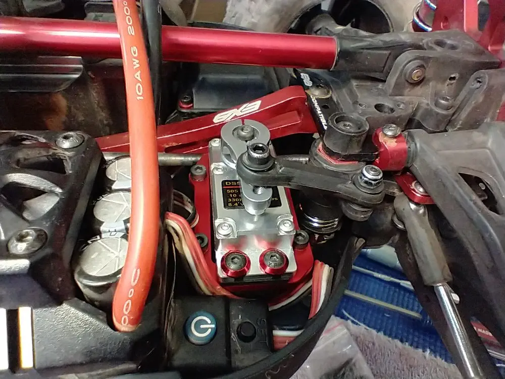

Now, you have me wondering as I have a ProModeler DS630BLHV sibling in a monster truggy with the same dimensions. When my current SCT410.3 servo (width 20.6mm) dies off I was planning on buying another ProModeler servo to use (SCT410.3 uses same side/mud guard used on MT410).
Could 0.4mm more in servo width be too much? I'll have to investigate this later. I'm not about to take out my DS505BLHV servo to install it into the SCT410.3 as I have to dismantle it (take the top off) to get it out of the mount (red piece in picture).
