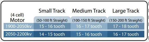

On the stock EB48 2.0, would a 17T pinion be a good place to start?
I don't want to have to deal with overheating issues etc!
Buggy will be used on 4S lipo, mainly on flat surfaces, just driving around generally in parking lots or gravel. Not competition racing. No jumps or heavy bashing etc.
Electronics will be XeRun XR8 Plus with 1900kv motor.
Have ordered a Robinson Racing Products Hardened 32P Absolute Pinion, 17T, RRP1717
Now thinking whether I got the correct pinion?
Check your temps, 17T (Mod1) may do fine:

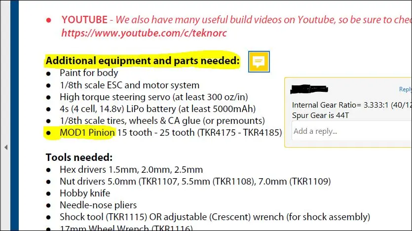

What gearing for upgraded electronics?
Page 21 of the Manual:
Thanks guys - changed order from 32p to Mod1!

I like to download the manuals before ordering the kit I'm about to build. Gives me a chance to look it over and possibly gives a heads up to something I may have overlooked.
Not all pinion gears are made the same. Please, let me know about your Robinson Racing pinion gear fitment. They are normally the brand I get, but I had (unknown brand) left over from my 8.2e buggy...didn't fit in the EB48 2.0's motor mount. I'm currently using an Arrma pinion gear until I find the motor's sweet spot.

Yup definitely should have read the manual first! Just glad it wasn't a more expensive part!
The Robson Racing pinion I got was a 32p 17t unfortunately. I'll probably sell to someone who needs it or just leave it in my tool box! lol

larger pinion will reduce acceleration and increase top speed, this can help settle the car down in technical sections, but too large of a pinion may make it more difficult to clear jumps with a short run up to where having faster acceleration (with a smaller pinion) can make it easier to clear jumps more consistently.... there is no right/wrong gearing, just what works best for you provided temps are within acceptable range.
Running a 5200mAh pack, to the point where LVC kicks in, will give me a good 17 minutes most days while using a smaller pinion gear. With motor reaching 160°F~168°F temps, that is just in my comfort zone. Everybody's motor choice and driving style will contribute to what is needed as far as gearing.
My lower budget 1900kv motor probably doesn't have the same quality components as the "big boys" have. The efficiency will be lower, and I accept that. Trying to keep a happy medium in everything can be a challenge.
For years, the go to combo was 1900kv and 16T pinion. For what it's worth, not every buggy has the same internal gearing. My last buggy had an internal gearing of 4.3:1 and the 2.0 buggy has a 3.33:1 ratio.
