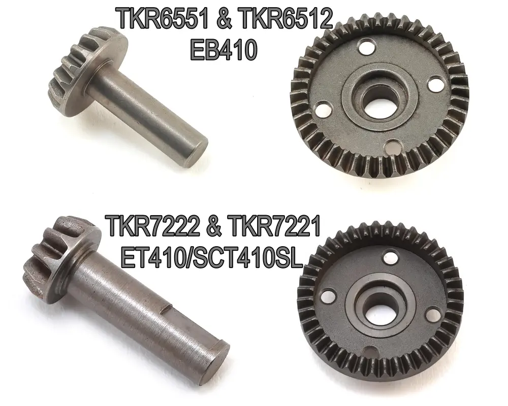

Some people are going with the EB410's diff ring & pinion gears in their SCTs.
If doing the swap, how for down on the motor pinion gear tooth count would a person have to go in order to have the same overall gearing as stock ring & pinion gear combo?
My math says its about a 6 tooth difference. EB410 gear ratio is 2.5:1 vs. ET410/SCT410SL's 4:1 ratio. Does that sound right?
