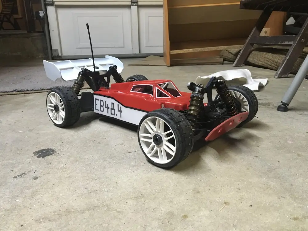

Here's my buggy conversion to give you an idea of what to expect:
Thanks @Billl DeLong ! Love that GT8 conversion by the way.

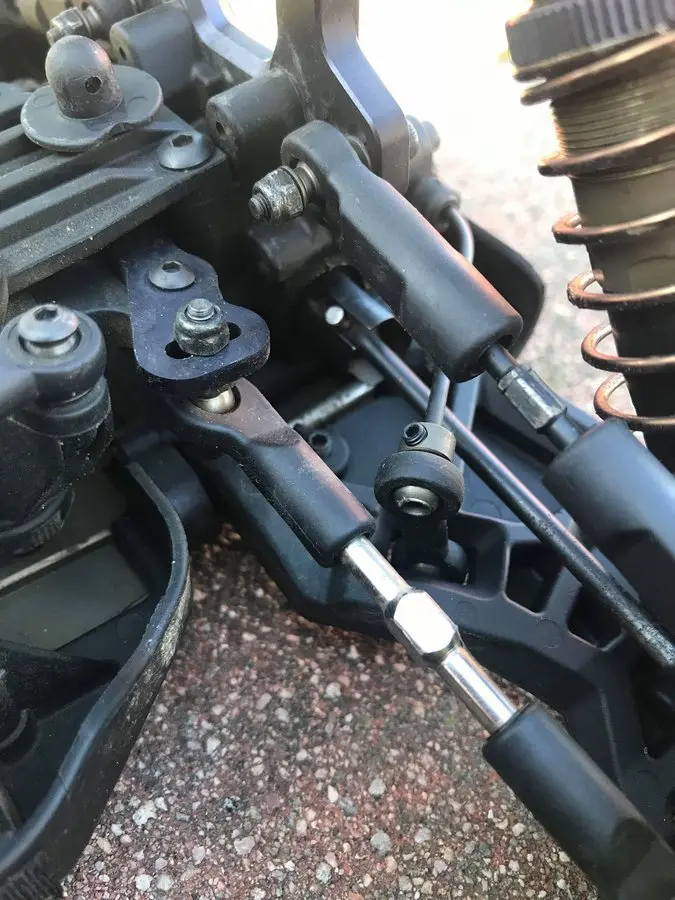

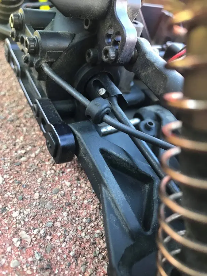

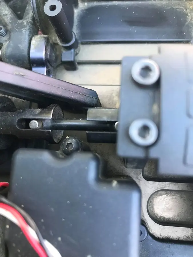

Following on the pin comment, how would you rate pin wear in the pictures below. This is from one of the rollers I'm discussing. They seem rather good to me. All comments are welcome.
Thanks,

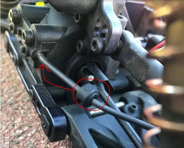

only concern I have is the following pic shows the sway bar guide not properly locked in, you might need to replace the grub screw to properly fasten it back in place where I placed an arrow on where it's supposed to be secured to prevent the bar from sliding out of place:
Good catch Bill!

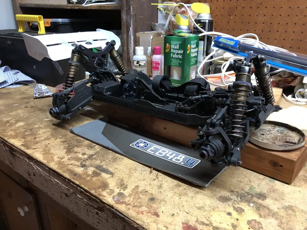

Congrats!
I would completely break it down to nothing but bare aluminum chassis, lots of grime will build up in hard to reach crevices. I'd lose the mud guards on the rear arms, extra sprung weight isn't necessary, especially for on-road racing.
To start out with I would get 300K diff fluid for both the front/center diffs and 40K fluid for the rear diff, that's the stock setup for the Serpent Cobra.
They also use 1K fluid in the shocks both front/rear.
I would get the hardest springs up front (Orange) and then run the Yellow front springs on the rear.
I would start out with a ride height of 10mm front and rear, box stock settings everywhere else, then make tuning changes from there.
Good Luck!
