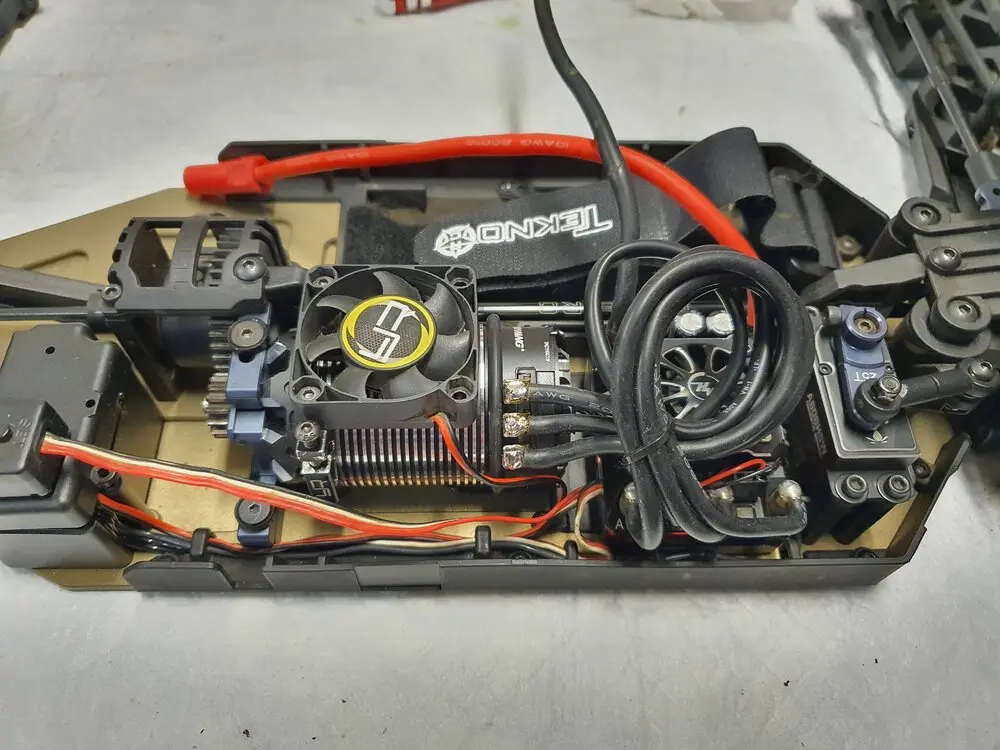

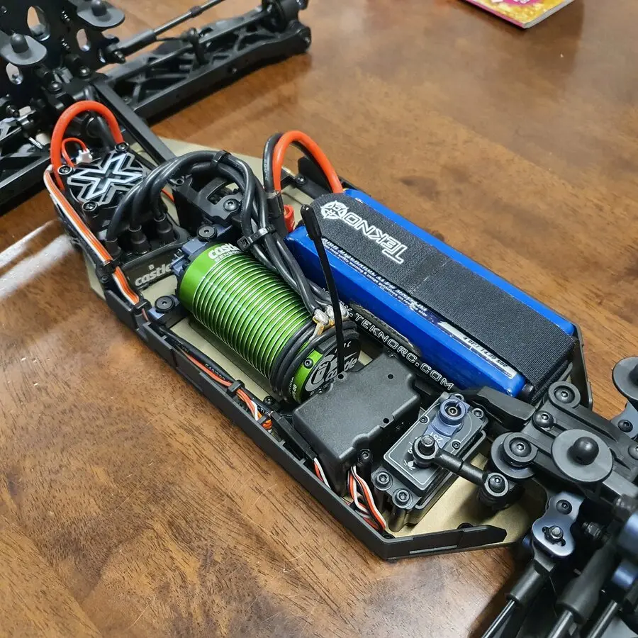

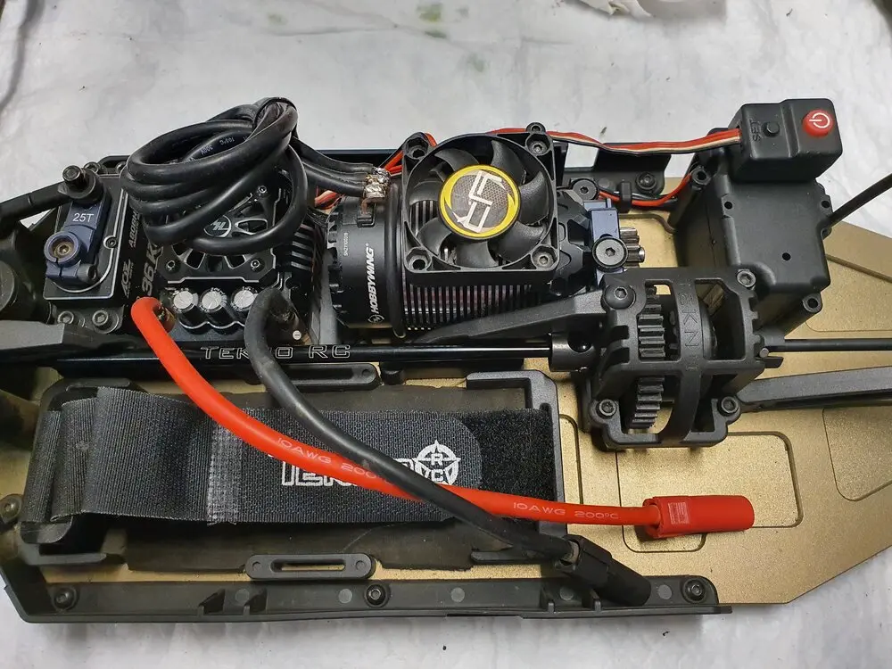

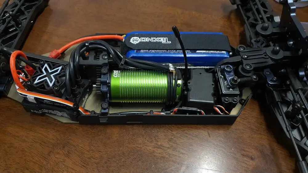

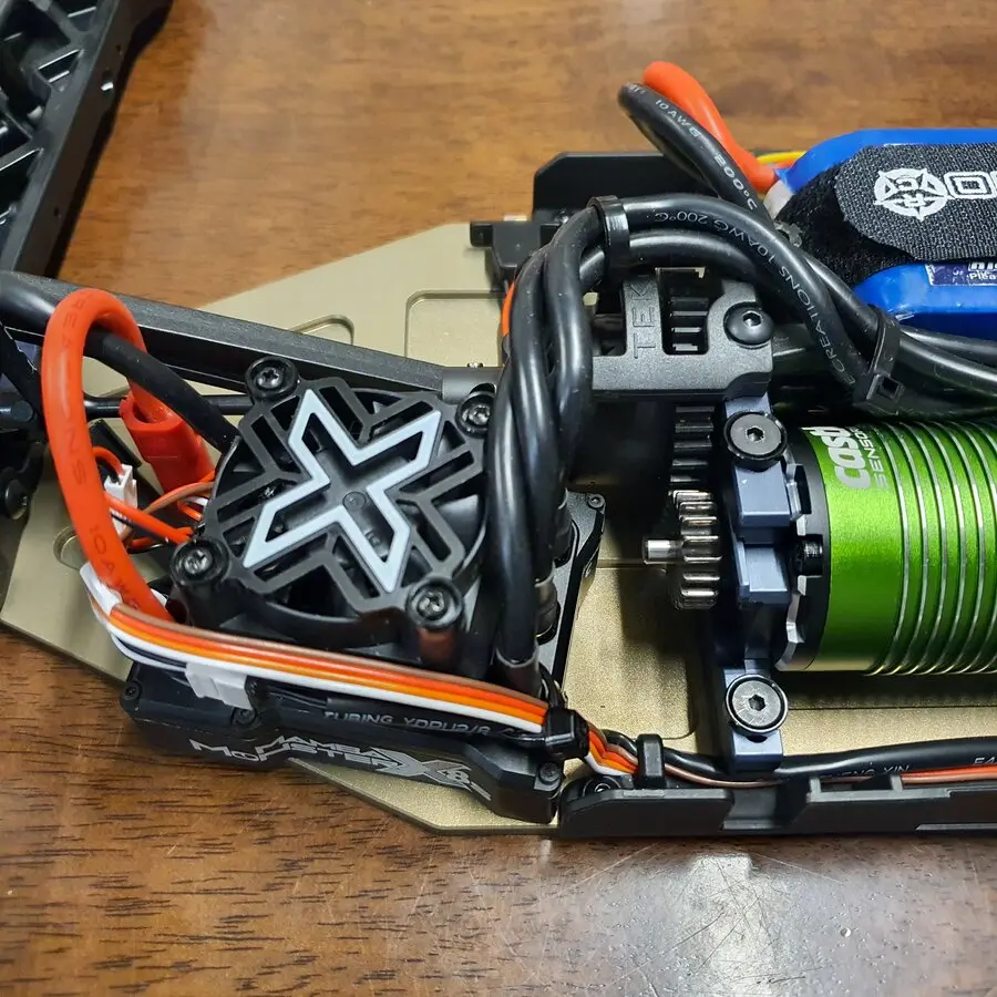

Hello and welcome! What will you be using the car for? Bashing I'm guessing? The standard build design is limited in esc and motor size, but if you install the esc where the radio box goes and the radio box where the esc works normally go you can fit a mighty esc and motor in.

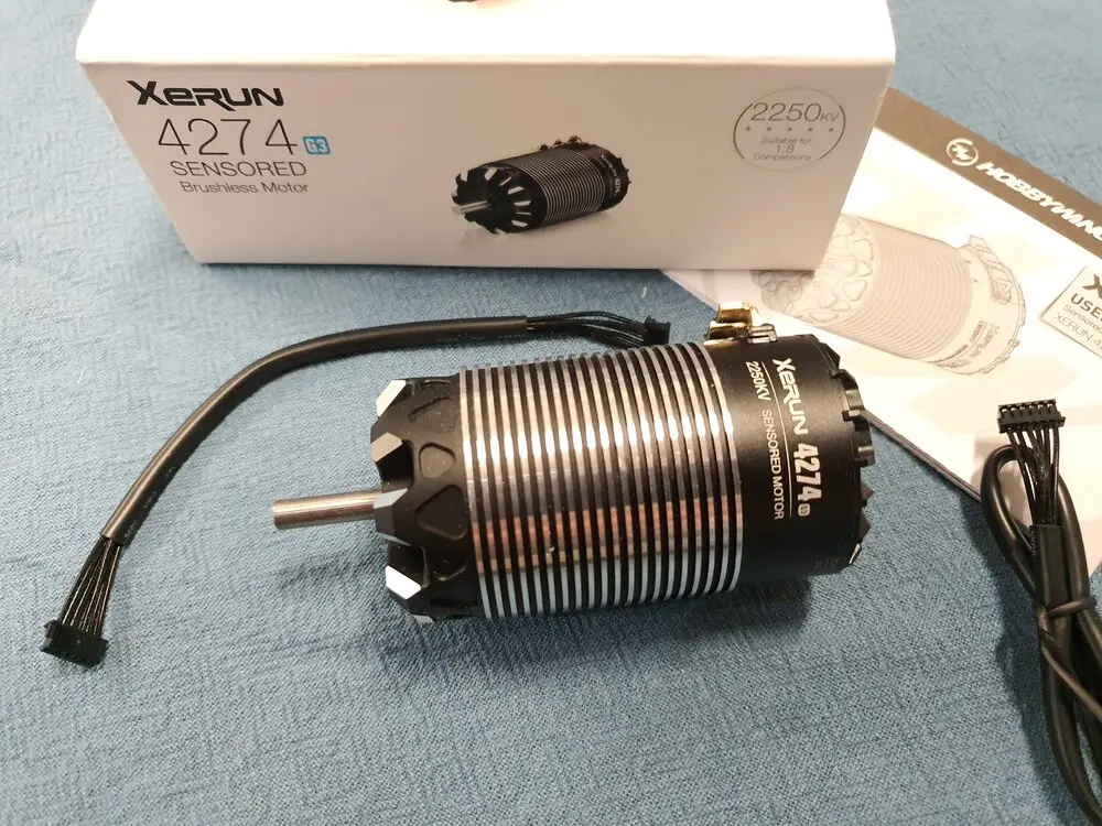

I've ran mine with a Castle Mamba Monster X 8s and 1520 1650kv combo, and a Hobbywing Xerun xr8 plus and 4274sd 2250kv combo, both run really well. With my race setup I prefer the Hobbywing system.

View attachment 7116View attachment 7117View attachment 7118View attachment 7119View attachment 7120View attachment 7121I’m strictly bashing, but would like to keep the option to run on a track in the future. I was thinking the same Hobbywing set up, the XR8 plus and 4274 since the XR8 pro is only 4s. Have you ran yours on 8s? That has to be on the edge of out of control, I know my MT410 is on 6s. I can’t go near full throttle let alone 1/2. Witch keeps me going back for more so maybe 8s is a option in my ET48 2.0 lol. Plus running on 6s most of the time will put less stress on the electronics, but I’d really like to keep the esc in the factory position.
Another vote the the XR-8 Plus and 4274 motor combo....
I went with the Hobbywing xr8 plus/ 4274 combo. There are so many options for steering servos, what do you guys think about the Reefs triple 4 servo? Anyone have experiences with it? For now I’m going to run a traxxas 2255 brushless servo that I have laying around…I have them in most of my Traxxas Rcs and my Tekno MT410…it won’t last long I know for sure, the case ovals out where the output shaft gear bearing rides, and c a ton of play in that area. So the servo horn wobbles all around. It happen on 2 of 3 that I currently use…real bummer for a $100usd servo…the case is aluminum but the top cap isn’t. Thanks for your guys input on witch ESC/Motor combo to use.

Hey PrimaRC, thanks for posting those pics bro, they really helped me out. I'll briefly tell you why. I have an mt410 with the 1520 and monster X 8s, doesn't over heat anymore but had to install the esc ontop of the front diff. Gonna get a et48 2.0 and thought of putting what I had in the mt410 that would over heat in the et which is a monster x with the 1515/2200kv motor. Didn't think I could do similar to the mt410. But seeing yours . . . .;) thanks !
