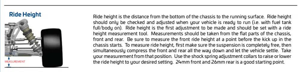

What you are describing is how you adjust the ride height. You will adjust those shock collars when you have everything all set up and you are RTR. You want the full weight of everything you would be running when you adjust them collars.
This screen shot is from the buggy manual.
The MT manual apparently does not have this very handy setup info which explains why MT owners (that don't have any other Tekno's) always ask these kind of questions. I am not sure why the MT manual does not have this basic setup section?
Unfortunately, it does not...
