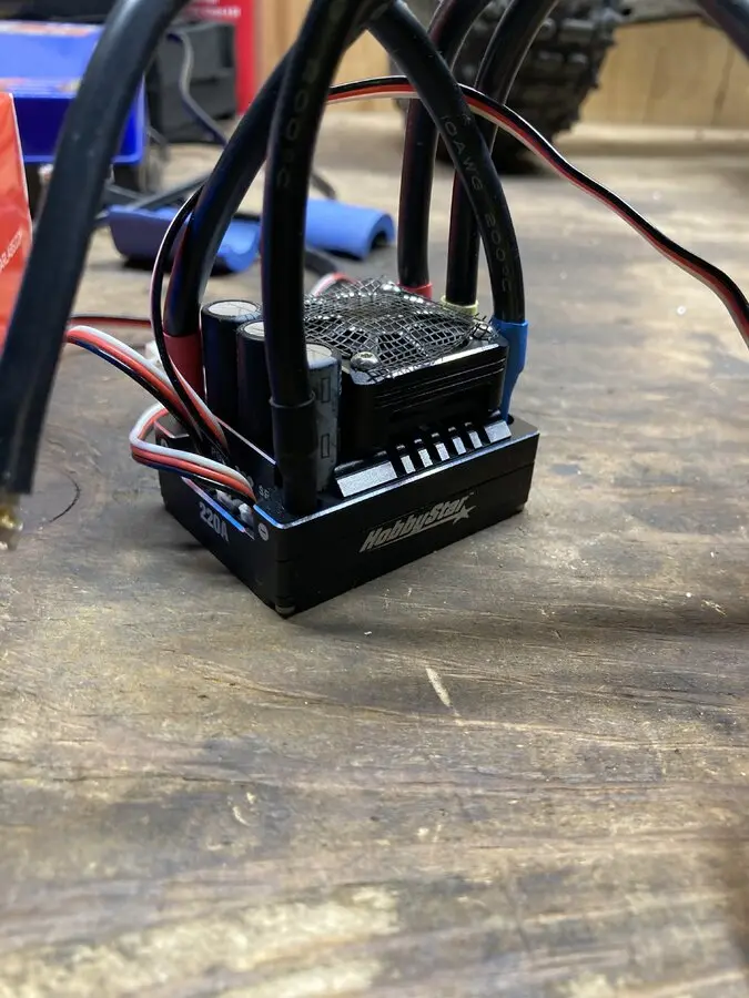

I wouldn’t get a hobbystar esc I got the 220A and it doesn’t work properly out of the box and RCJuice won’t respond to my emails on how to go about getting it warranties. I do and still will buy motors from him in my ET48 um using a max8 esc with 2000 kv 4076 motor in my EB48 um using xr8 plus and surpass hobby rocket 4274 sensored 2250 kv love both combos. I’ll be replacing the max8 with a xr8 plus and sh rocket 4274 1700 kv in the ET48.

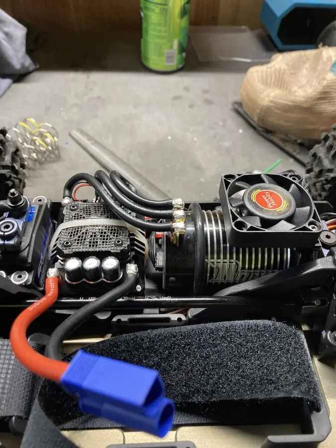

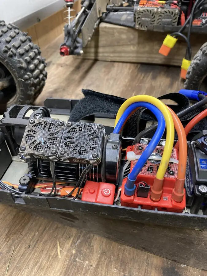

What motor fan/heatsink is that? I notice on the ET48 2.0, the motor is very close to the center brace.
thanks for the feedback guys. That's very good to know about Hobbywing's warrenty and discounts.
Powerhobby on the eb and nitro hobby dual fan on the et
