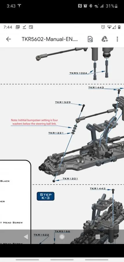

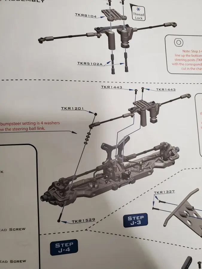

So I am not sure if the following is correct as per the manual. It was posted on the Tekno facebook page but I wasn't able to make sense of it. At any rate, should the screw be going in from the bottom as depicted in the manual or from the top? Also, is the nut suitable?
If you're talking about TKR1529 and TKR1201 (along w/ the washers depicted) then yes, that's the correct orientation. Why do you ask? Are you encountering some unexpected issue on this step?
Good luck w/ the build!
Was he wrong to flip it the other way? Or is the manual correct? He said
'You don't put socket head cap screws in hex pockets'
This the ET48.3 manual where it is the opposite of the MT410 manual
I built my MT410 per the directions, screw on bottom nut on top. The longer arm of the MT410 means the clearance between the steering spindle (TKR5193) and the arm is very tight (much tighter then my SCT410 which is built screw down). Placing the screw down on the MT410 would likely end up with a clearance issue with TKR1529 hitting the arm on full steering lock, especially at full droop. My guess is there is more clearance on the buggy.

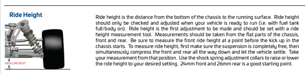

Thank you! Another question, the manual has the spring tension rung nut all the way to the top, however every pic Ive seen of MT410's, none of them have the spring ring nut all the way top. What is the best positioning for the spring ring nut on the shocks for bashing for both and back shocks? Pictures would be great!
Thank you!
Thank you!
What you are describing is how you adjust the ride height. You will adjust those shock collars when you have everything all set up and you are RTR. You want the full weight of everything you would be running when you adjust them collars.
This screen shot is from the buggy manual.
The MT manual apparently does not have this very handy setup info which explains why MT owners (that don't have any other Tekno's) always ask these kind of questions. I am not sure why the MT manual does not have this basic setup section?
