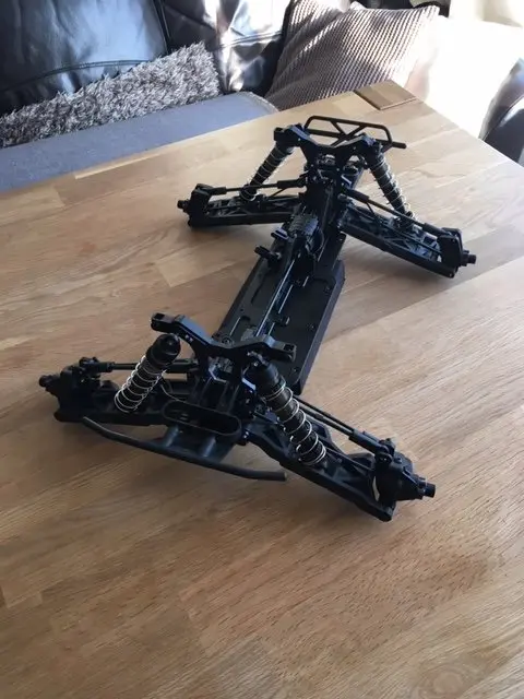

I completed my MT410 build yesterday (which was a pleasure) and I am now thinking of what motor and ESC I should use.
Just a thought I have an Arrma Kraton 4S which no longer works (because it is rubbish, the slipper clutch will not stay tight) and I could remove the electrics from this and put it into the MT410. What do you guys think, would it be suitable? Spec's listed below. If you think this could work what pinion should I run?
If I have to buy new electrics it is not a problem, just thought I could recycle some other parts? They are quite new as the Kraton has only been used about 5 times before it gave up the ghost!!
I know it is only rated to 4S but I think this will be ok for the truck? Any help is much appreciated.
Oh yeah I am thinking of having either the Arrma backflip tyres (off the 4s outcast) or the proline badlands.
Any help is much appreciated, go easy I am relatively new to RC.

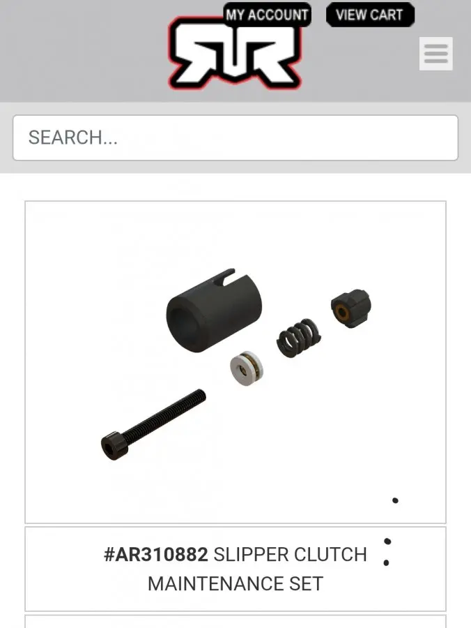

I have owned an Arrma and repaired it myself, but first order this part, arrma is known for this problem with the slipper. Before installing clean the screw and remove al grease, then when installing use blue locktite and leave allone for at least 24 hours.

I have owned an Arrma and repaired it myself, but first order this part, arrma is known about the problems with the slipper. Before installing clean the screw and remove al grease, then when installing use blue locktite and leave allone for at least 24 hours.

I have tried the maintenance kit, unfortunately the slipper clutch stays put for a bit but it goes loose soon enough. It is a design fault I think. I have tried red loctite and left to dry for two weeks, still comes loose!
