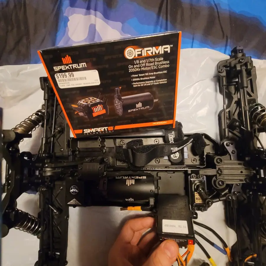

Anyone running the Mt 410 with arrma spektrum firma 6s esc and motor system I have the esc and motor out of my notorious 6s to test fit I already have spektrum smart lipos so I thought I this would be a good choice I would have to clip off the mounting holes an adhesive the esc down to make it fit should I use this esc an motor glued down is that a good idea or should I go with a different motor/esc option any advice appreciated
Anyone running the Mt 410 with arrma spektrum firma 6s esc and motor system I have the esc and motor out of my notorious 6s to test fit I already have spektrum smart lipos so I thought I this would be a good choice I would have to clip off the mounting holes an adhesive the esc down to make it fit should I use this esc an motor glued down is that a good idea or should I go with a different motor/esc option any advice appreciated View attachment 6791
I remember doing this with a BLX185 (same HobbyWing roots) and it is still running strong after a few years. I double sided tape it and ziptie.
I ran my v5 typhon electrics in my mt410. It was beast but ran warm on 15t pinion 6s. 2000-2200kv is to much for this truck on 6s imo
