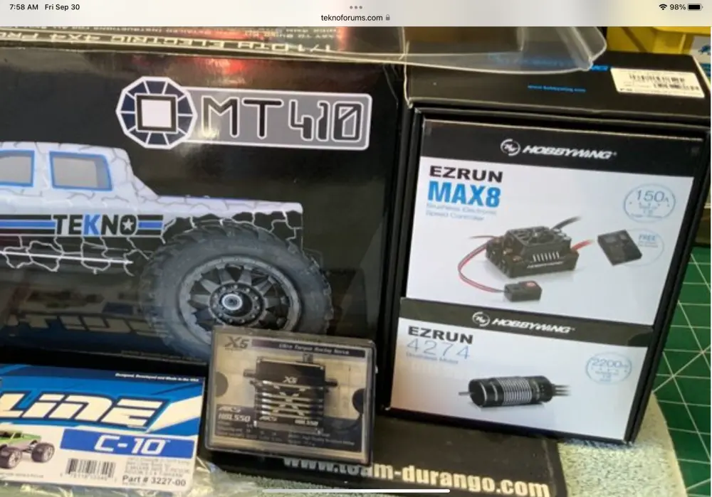

This is what I’m running on 4s and it’s very satisfying. Mines completely stock and is holding up well.
Echo ⬆️
This is what I’m running on 4s and it’s very satisfying. Mines completely stock and is holding up well.View attachment 8856
Yup, that's a sweet combo for the mt410. I just switched mine from a 2050kv blx to the Tenshock 2200kv..just thought it might be a better use of the Tenshock 2200..had it in a mojave exb. Going to give it a thorough test this weekend.😎

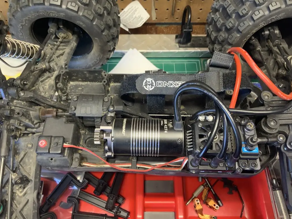

Thanks for the info guys, cheez is that the G2 max 8 and does it fit normally or you had to relocate the esc? Also what is the benefits to a larger can lower temps? If you get a larger can do you keep the kv the same or adjust either way?
Yes it is , fits fine. The power switch can actually be routed under the center diff to the other side (just barely) or add an extension. Gonna reroute it next time I tear it down.
Yes it is , fits fine. The power switch can actually be routed under the center diff to the other side (just barely) or add an extension. Gonna reroute it next time I tear it down.View attachment 8866
The problem is not the new ESC , Max8 G2. It’s the 78mm can that comes with it. I don’t see a lot of room for the extra 4mm of the new motor.
Agreed, the picture that @Cheez shared above pretty much sums it up. I wouldn't be comfortable with the esc and motor actually touching each other before you even turn it on. LOL
