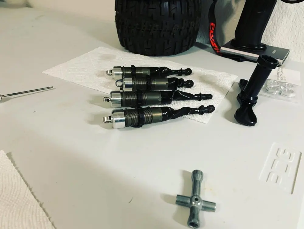

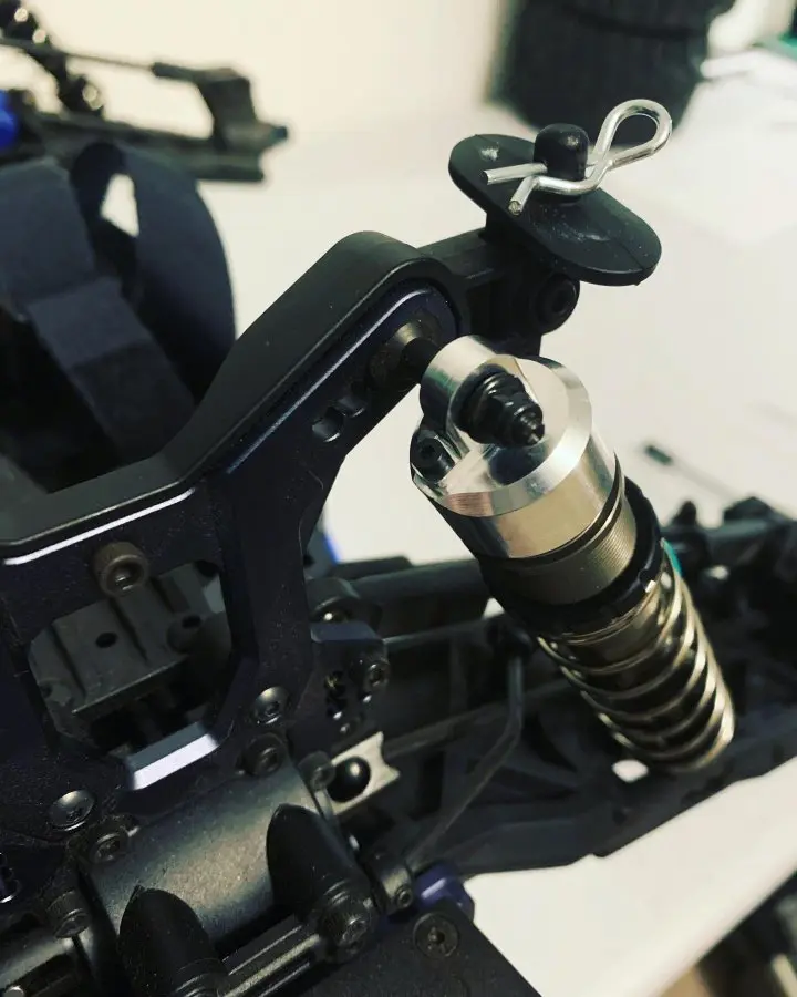

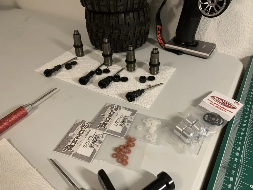

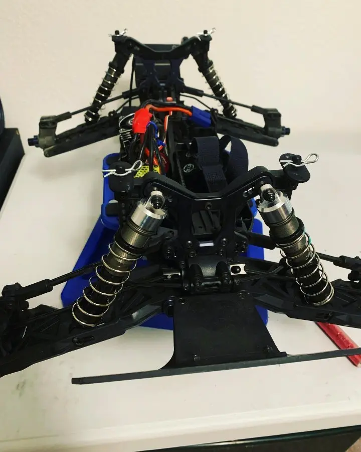

It was a super fun build. I enjoyed almost every minute. I had quite a time getting the shocks to stop leaking. 2 of them I had to pull apart 3 and 4 times. Cuz 1/4 turn to loose and oil came out the bleed hole and 1/4 turn to tight and the bladder sucked down into the shock itself. Kinda made me mad but its all working now 🤞🏻, I just got trust them. I’m having a buddy paint that body for me. I don’t like paint nor do I even care to learn and he loves it so that worked out for me. I really appreciate this forum it helped a few times. Keep up the good work guys.
Had the bladder issue on my last MT 410 build. Think I was distracted and forgot to use a little oil on both sides of the bladder so the bladder would not catch on top of shock metal.
Ended up doing the emulsion M2C caps and all seems perfect now. Love this new truck.AC525909-0357-4D5F-9CC5-69DB2D3525C7.jpegBE6FDD8C-410F-42B6-BBDB-C9B302EC3ED8.jpegE3BAD040-D602-4EB9-B7C3-A112FDF7E28D.jpeg
