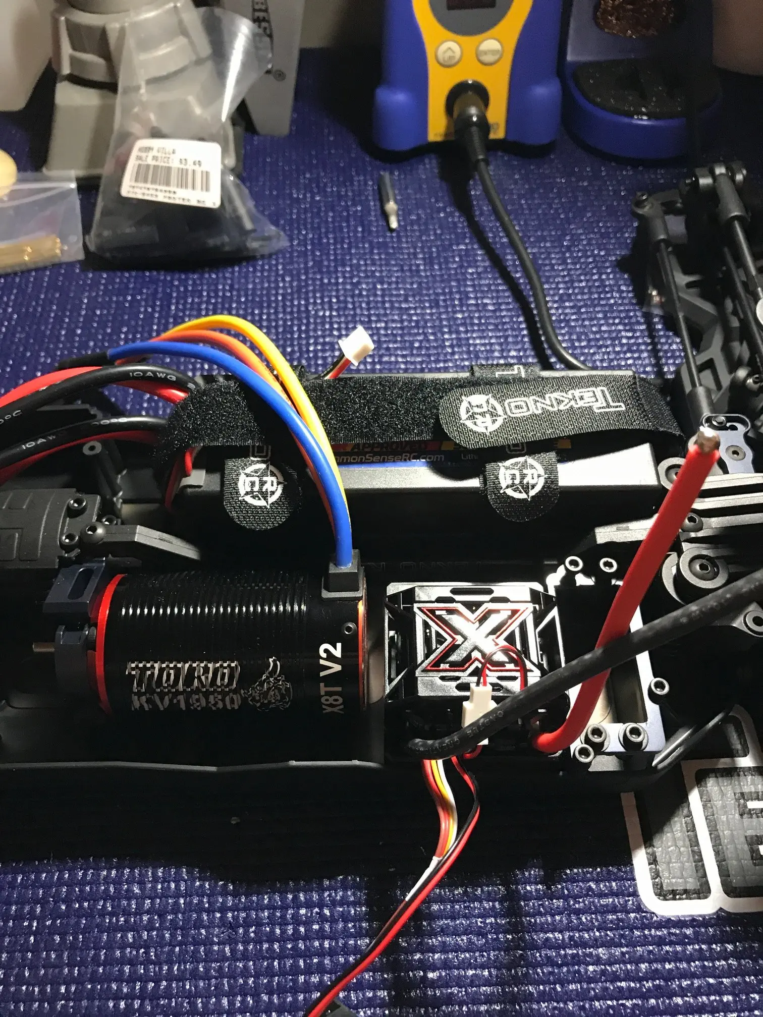

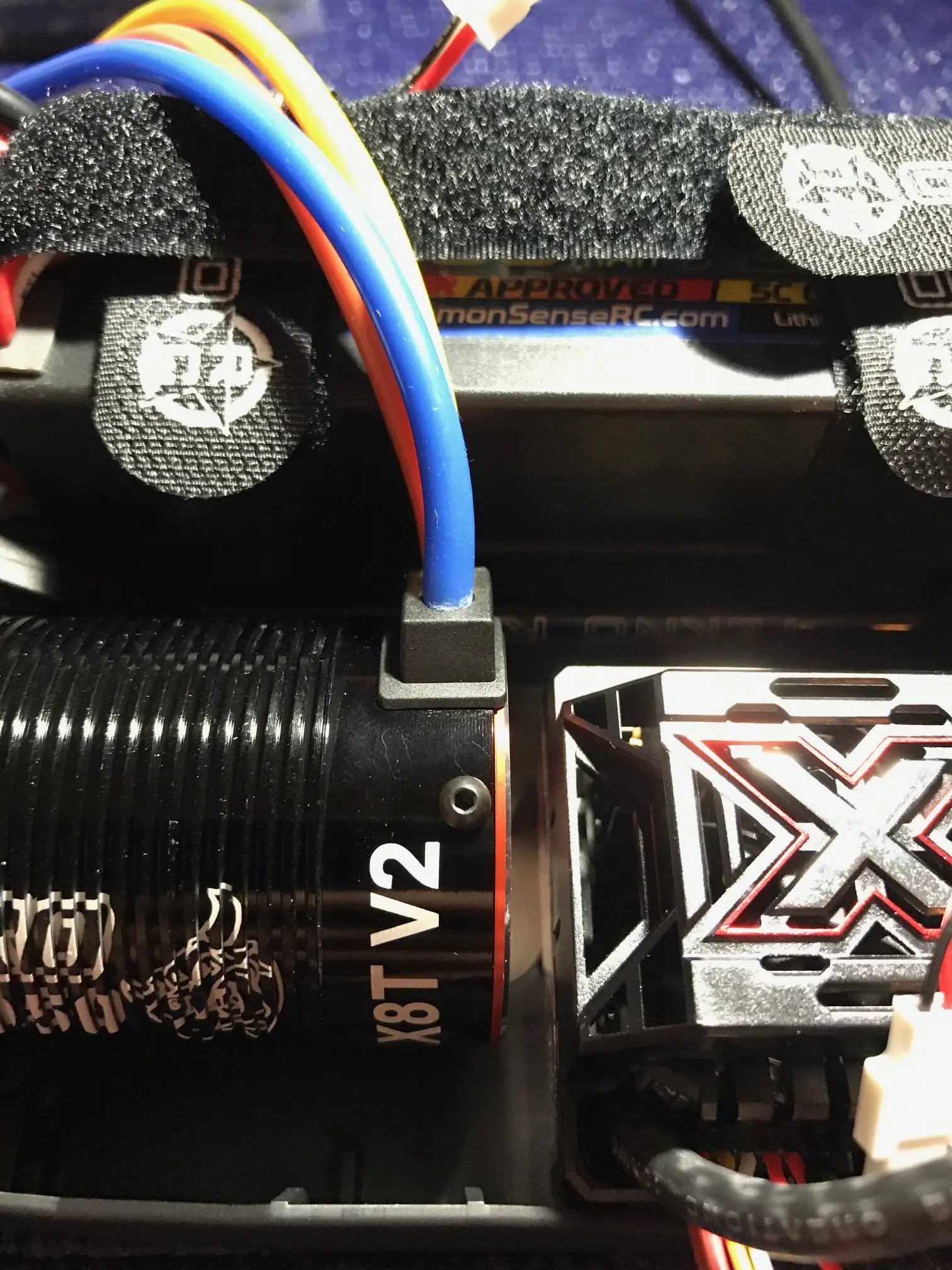

Well I didn't get to mess with it last night and just started on it today. Looks like I have plenty of room between the Toro X8T motor and the Mamba Monster X. I'm wondering if I should be using Castle Connectors over the XT90's....what do you guys think? Any benefit over XT90's?
@Mongoose I've not had any issues with the Castle Creations bullet connectors, but if you have a bunch of other stuff already using the XT90's then for simplicity I'd probably stick with them instead.

I agree with WoodiE, that if everything you have runs XT90, I would stay with them as that system probably pulls the same amps as the Armma vehicles. I have all of my vehicles (except my mini revo but that takes completely different batteries) switched to XT150, but I also run 8s in my Baja 5B and that's why I upgraded them. If I didn't convert my Baja, I would have stayed with XT90 connectors.
I wonder how much room I will have in my MT. Hopefully I get to finish that up this weekend.
I have a Monster X with the Castle 2200kv in my SCT410.3, I have about the same clearance. MT410 and SCT410.3 use the same chassis.
I think all electric Tekno vehicles use roughly the same mounting locations on the chassis. Except the EB410.
That is awesome to hear. I want sure if the truggy had more room because of the longer chassis. Anybody know what the longest can you can get in there is?

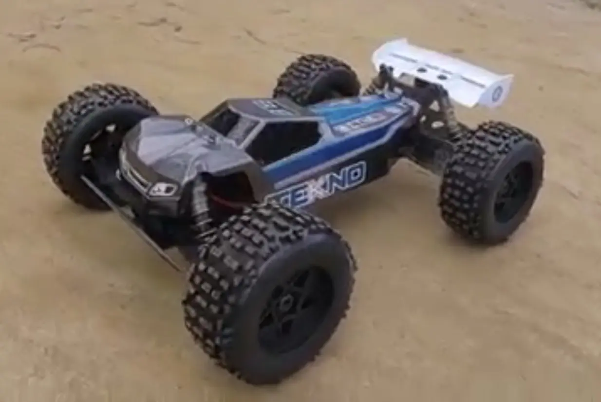

My plan is to mimmik RC OFF-ROAD DOWNUNDER's ET. I think it's one of the cleanest ones I have seen...simple but clean.
Check him out on YouTube!

Well I didn't get to mess with it last night and just started on it today. Looks like I have plenty of room between the Toro X8T motor and the Mamba Monster X.View attachment 13

hey mongoose what is the rc downunders ET?
It’s a guy on YouTube’s name. I really like his paint scheme and I’m going to paint mine somewhat like his.
