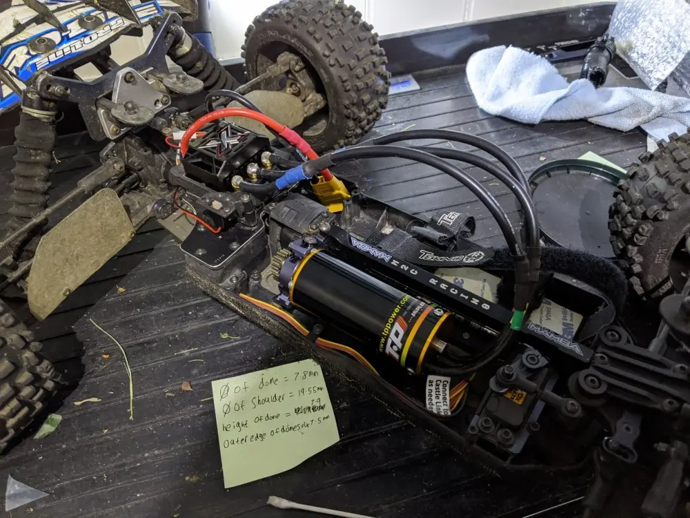

I use the RPM cage to mount my Mamba monster
Cool, looks custom. Is there a custom aluminum cover plate above the receiver box? Both mounting holes for the ESC cage in the cover. More pics, perhaps? Any idea if this high stacking approach is needed with a long can motor AND the m2c chassis?
Below the RPM cage is a custom made aluminium plate. The RPM cage has two holes which are used to put bolts through to underneath the plate, then m3 nuts to secure it.
The whole plate threads into the receiver box lid and throttle/brake servo mount.
I believe that with the m2c wide chassis this adaptation would not be required, even with long can motors.
