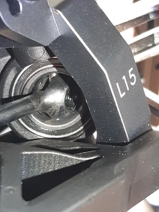

You might have assembled the CV joint incorrectly. Please read through this thread to see what I mean.
Hi, Read the thread you linked to, thanks. I had the whole frontend off and checked through things including the bulkhead being screwed into the chassis 100%. Everything seemed fine.
Here is a photo of the CV Joint, looks correct to me.
Cheers!

It's interesting to see wear on your cv like that since it is new. Unloaded suspension, suspended car on a stand, will make things look worse than they actually are though. You could temporarily adjust your droop screws to simulate weighted suspension angles and drive line angles for a test to see what difference that makes.

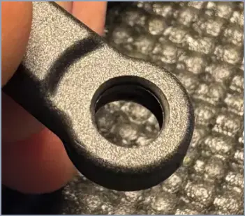

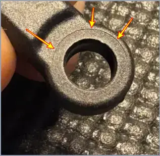

Even though I've never seen a Tekno 1/8 manual state such a thing, a couple people have mentioned a right/wrong way to insert pivot balls into rod ends. The said "correct" way 🤷‍♂️ is to insert the pivot ball through the side of rod end with visible ring...
I highly doubt any right/wrong pivot ball insertion is causing your issue @RCFinger .

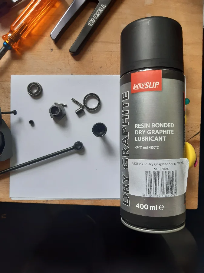

What you see on the CV that looks like wear is the Dry lube i used, instead of a thin layer of grease. It's called Molyslip. It has a weird grey look to it when dry. I have cleaned it off and used some grease just in case.
I was aware that it was being tested on the stand, so after you mentioned it, I cable tied the arms so that they were level with the chassis, no improvement unfortunately :(
View attachment 10711View attachment 10712
Yeah, rod ends on every kit I have assembled have had that mark for as long as I can remember. If you measure each side with calipers, you will see that side with the mark is bigger.
What measurements are you getting? I'm not seeing any difference (6.28mm)
They may have a molding mark, but the only time I've ever seen any manual mentioning a pivot ball being inserted through one side vs. the other side of a rod end was... never.
I was hoping @Matthew_Armeni would have shed some light on the rod end subject/picture in post #11.
Yeah, it has never been mentioned as far as I remember in any of the kits I have built. I have measured them on other kits before and have seen differences though, for certain.
It was years ago when I first checked them because I did notice some were like impossible for me to press the rod end on the ball. But every time, if I flipped the rod end over, it snapped on there fairly easily. I didn't have shock pliers back then, so I was just setting the ball on my bench and pressing the rod end on with my thumb. But there was a noticeable difference, and it was the ring side on every one of the rod ends that was easier to press on. And since every rod end has that mark, I have been doing it that way ever since. I wish I knew why that ring is there, but I have just assumed it is an indicator to show you which side the ball should go in.
It wasn't until I started working in the racing industry that I actually saw something similar when we were making IndyCar wishbones (A-arms). We machined the rod ends, and sure enough, one side was machined bigger so the ball would press in. But these were steel of course. But after the ball was pressed in, a ring die was pressed around the outside of the ball to lock the ball in place by pinching the material around the ball. You would not believe how little material there is holding those balls in place on IndyCars.
So maybe RC adapted that "look" to show which side the ball goes in? I have no idea. But isn't it interesting that every rod end has that feature, and there has never been any explanation why?
So I though I would try to see if I could show the difference with an image, but it was clearly more visible when I changed the opacity back and forth. And the only way for you to see that is with a video.
