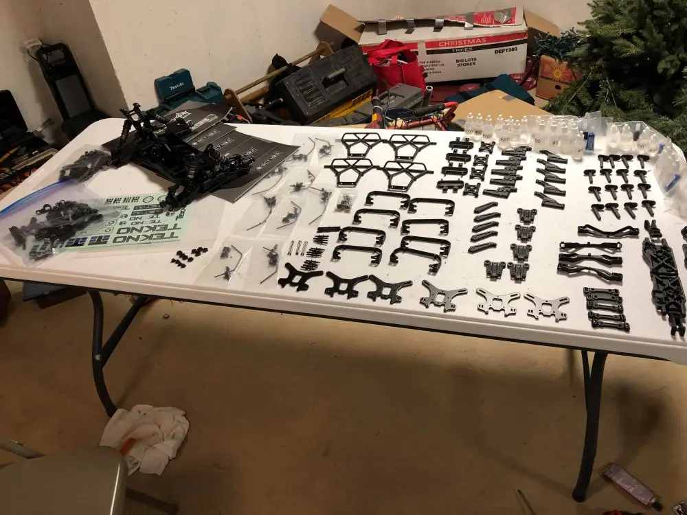

I did consider contacting the guy, but right after this post I found a super great deal from another guy and bought a brand new kit with enough extra parts to let a lifetime. Didn’t come with “extra” shocks but did come with everything included from the factory kit and then tons of extra shock towers, arms, bumpers,oils etc. couldn’t have been a better deal and couldn’t have been a nicer guy to deal with. So the plan now is the use the new kit to build my db48 and used one with different shocks to build a 4x4 drag car or off-road buggy of sorts. Not sure yet. My buddy is trying to get me to build a Subaru bodied “AWD” drag car..
Here is all the stuff I picked up, all brand new for
cheaper than the kit would have cost if I bought from store or online shops.
