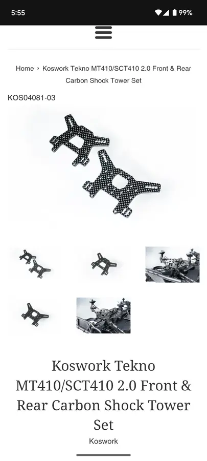

So in my excitement finding a set of MT410 shocks on eBay last night I purchased a set of MT410 shocks for my sct410.3. Not 🤔 thinking about the shock towers. Can I just put MT410 shock towers on to make the longer shocks work on my sct410.
Would these work?:
I know there's been lots of threads on here about shocks I'm sorry in advance. Just looking for some advice on a Hasty purchase I made.
Thanks
It's not that simple because the MT has longer arms from the truggy so the longer shocks will account for the extended overall geometry.
I suspect you'll blow out the MT shocks if you install them on the SCT even with the MT towers :(
