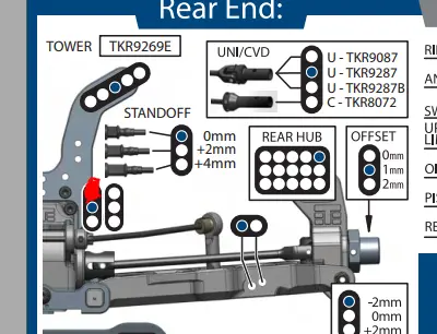

Thanks, you are referring to the shock tower right? So where the red dot is?
When/ why would I need to adjust the camber connection to the rear hub options?

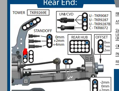

Yes, of course, you could play with the roll centers at the hub camber link as well. I couldn't tell you which would have a greater effect though. Softer sway bar would help get you more traction as well.
