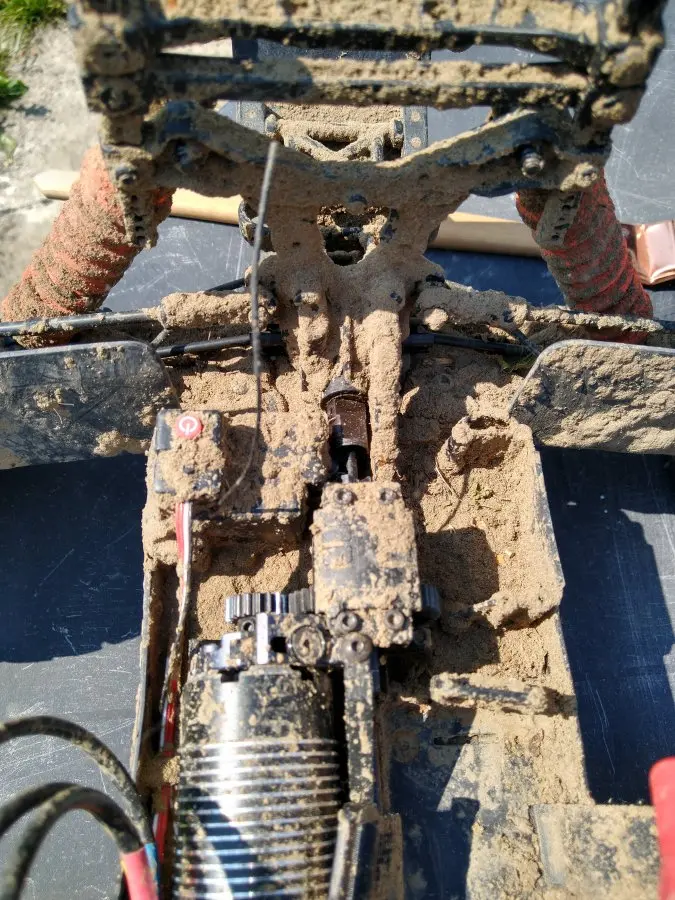

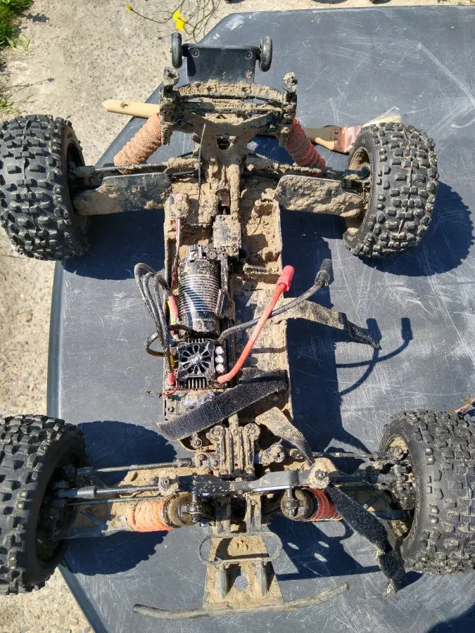

I went to the forest and my car came out looking like this:
Chunky:
Chucky close-up:

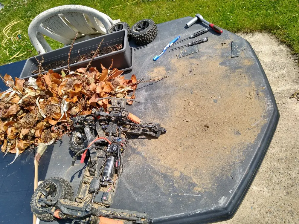

When I had cleaned it 10%, this is what the table looked like:

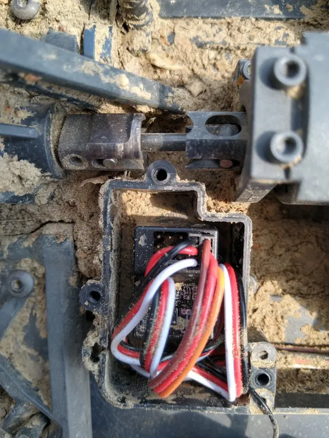

Even in the receiver box it went:

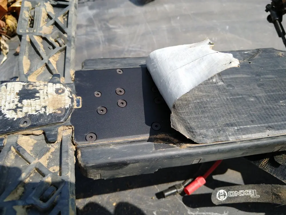

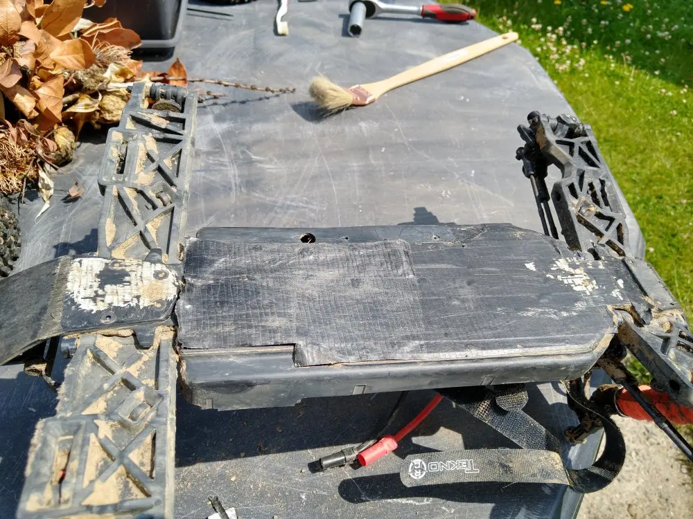

I taped up the chassisplate before going there:
Still clean underneath :love:

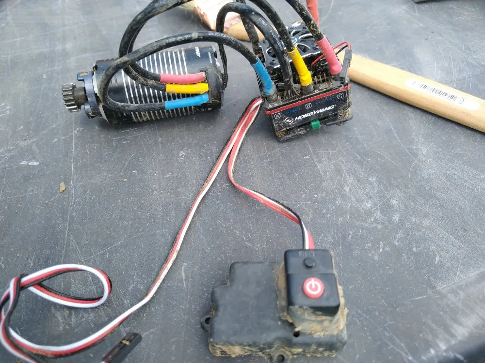

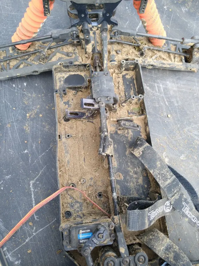

After the removal of the electronics besides the servo (removed this later):
The electronics themselves look pretty decent:

Yikes! Sand is bad for the bearings.
Since you’re already halfway there with the electronics removed I would remove the front and rear clips, wash the chassis with soap and water, remove the diffs and check the bearings and then clean out the diff case, then wash the front and rear clips with soap and water. Dry it all with an air compressor. Then clean up your motor and ESC with an air compressor, brush and then wipe down with a wet rag.
Looks like you had fun!
I don't have an air compressor :/
What do you mean with clips?
To get that clean as I would want it you would definitely need to do a complete tear down and clean the parts individually as needed. Paying special attention to the bearings. If you do use water to clean up everything just be sure to dry out the bearings ASAP or they will rust/seize on you and then apply some new oil.
If you keep everything all assembled and take an air compressor to it (which it sounds like you don't have anyways) there is a good chance you will actually blow more dirt into the bearings and other spots where you don't want it. Get the majority of the dirt off by hand, rags and with a small brush first. Old tooth brushes work great for the nooks and crannies.
