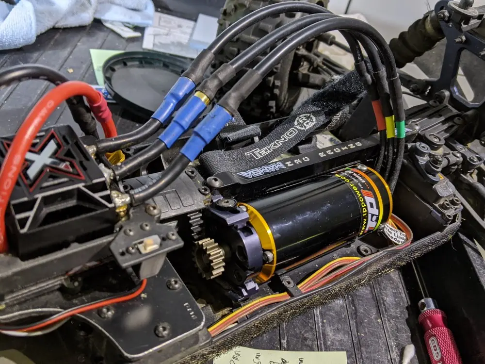

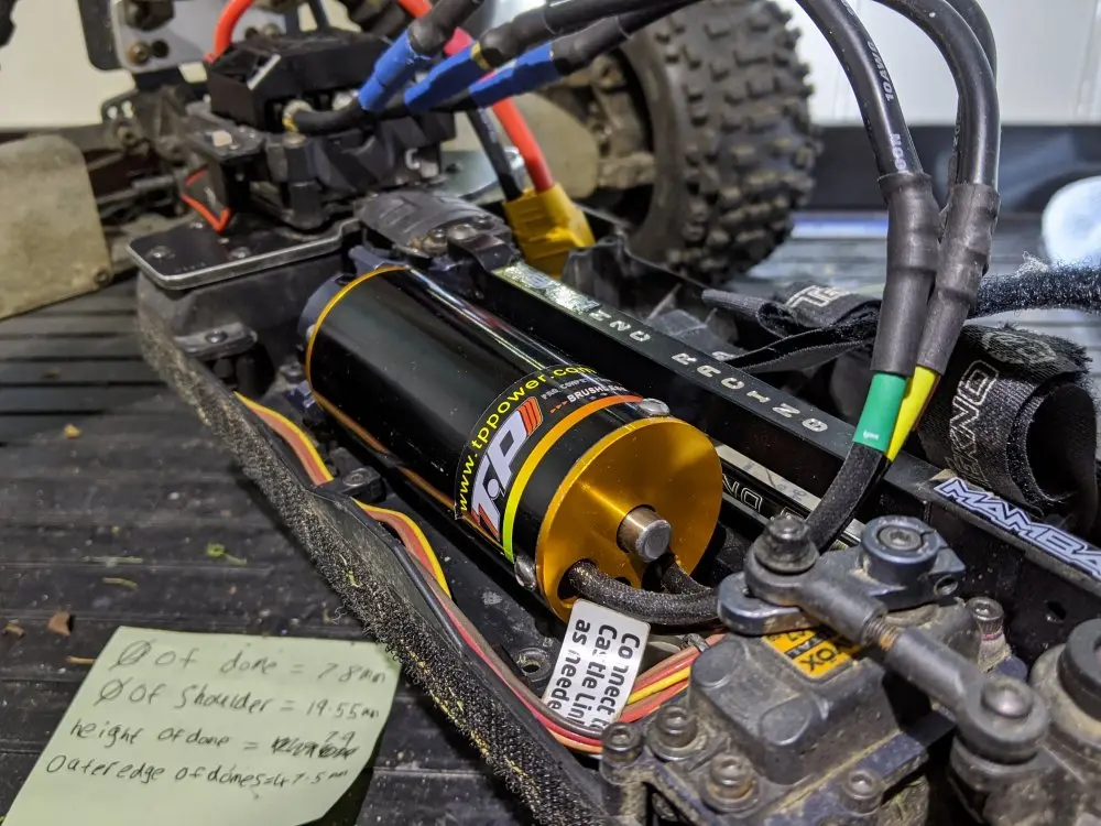

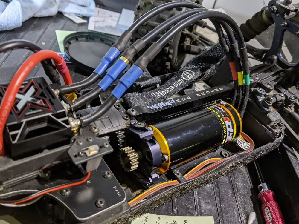

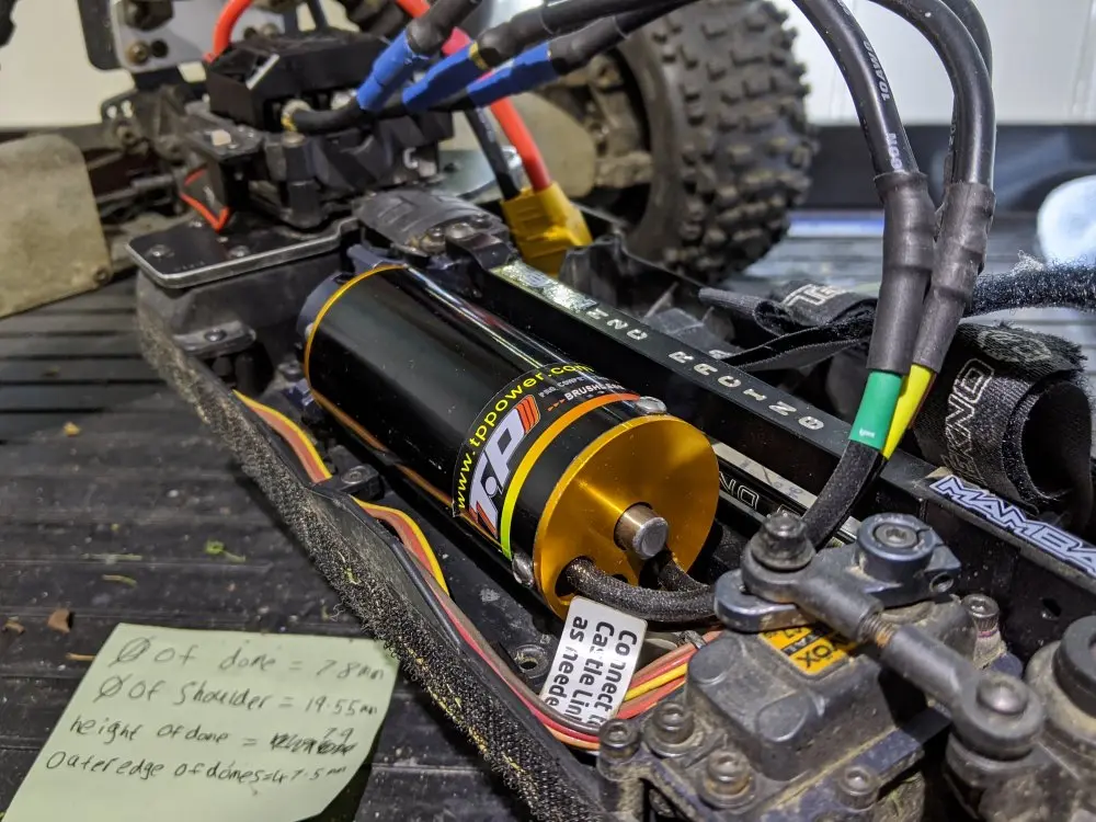

I run a TP 4060 1750kv motor (40x92mm) on 6S with a Castle Mamba Monster X ESC; 17t pinion 44t spur. Originally Badlands 3.8 tyres, now running Backflip LP tyres.
I used to have a Hobbystar 4082 1650kv motor.
Comparing the two, the TP motor is definitely more powerful, particulary in on demand low-mid speed torque. It runs slighltly cooler, not a lot, but it is geared higher so is reaching a higher top speed of around 60mph!
The aim was to make a crazy fast ET48 that would hopefully not overheat while blasting around on grass. The previous 4082 motor was decent, before that I had a Hobbywing 4074 2200kv which did always run pretty hot on 6S but was pretty powerful for it's size. Since I didn't want to compromise and gear down to make the motor cooler, I embarked on finding the ultimate motor.
I do believe that this is one of the best 6S setups for a ET48 or MT410. However, it is worth mentioning that I have had quite a lot more drivetrain issues since running this system, everything from driveshaft pins snapping to spur gear stripping and very regular tyre blowouts. If you want a reliable car, this is not the right setup!
I would therefore reccommend a 4082 size 1700-2000kv motor a a good middle ground, combining that with the best ESC you can afford, a Hobbywing MAX8 as a minimum.
