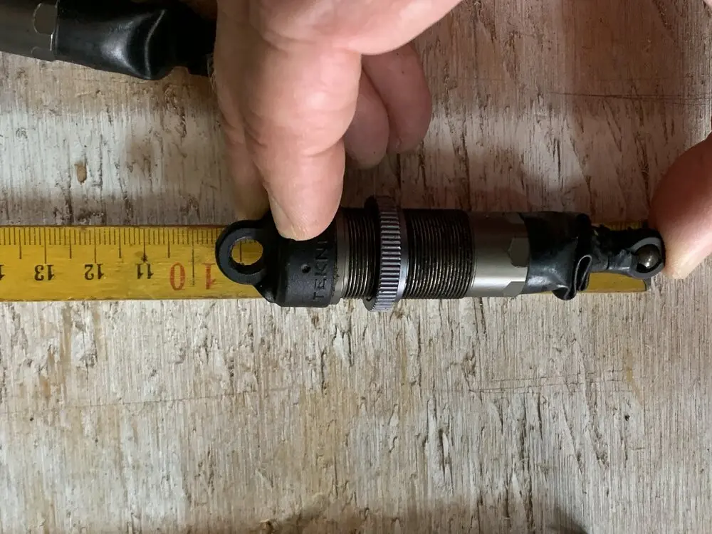

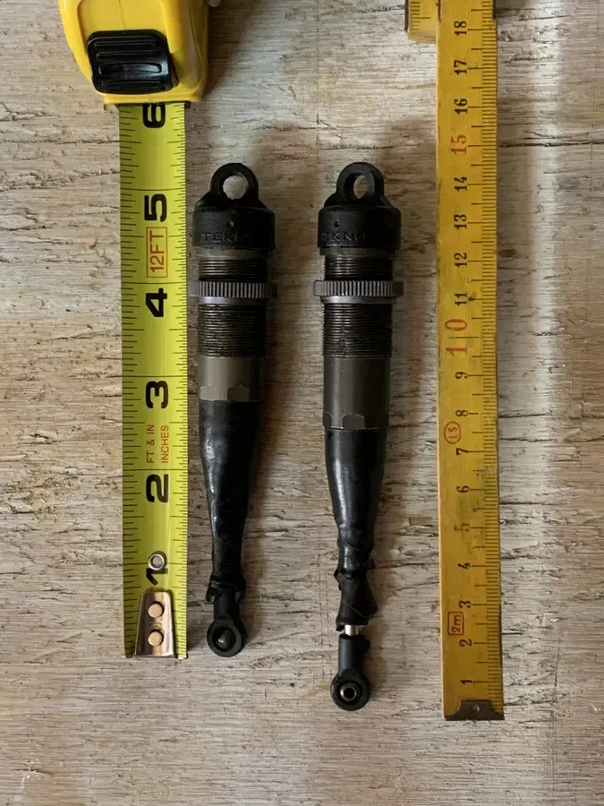

Perhaps they're not bled completely and are hydo locking. If you partially or completely remove the shock you should be able to completely compress them to where the lower rod end contacts the lower cartridge.
Here are a few pics that may help:
This is the front fully compressed: (95mm)
