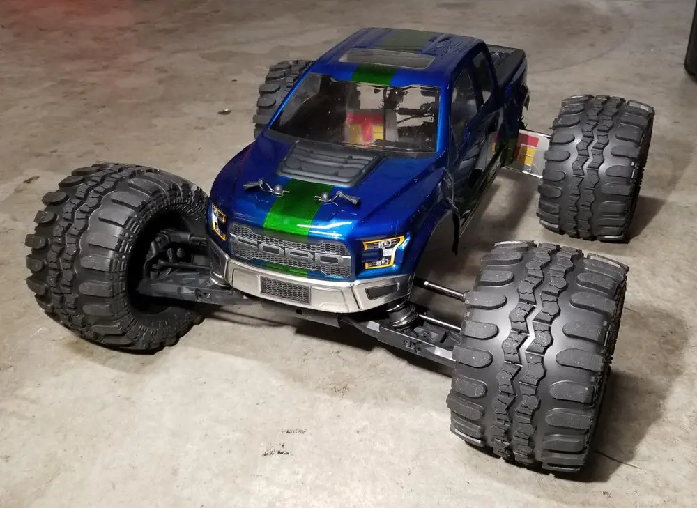

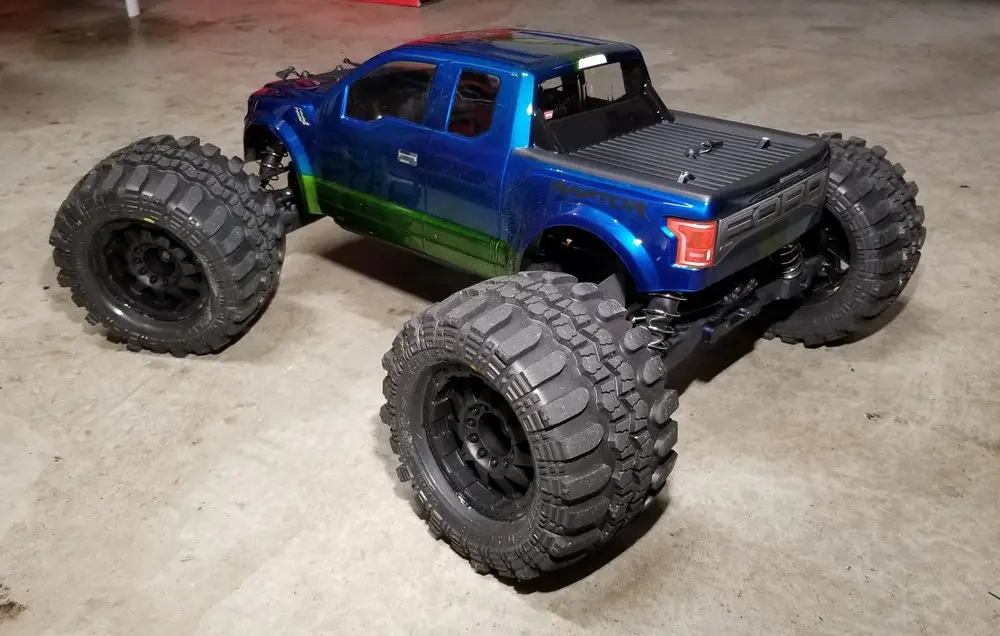

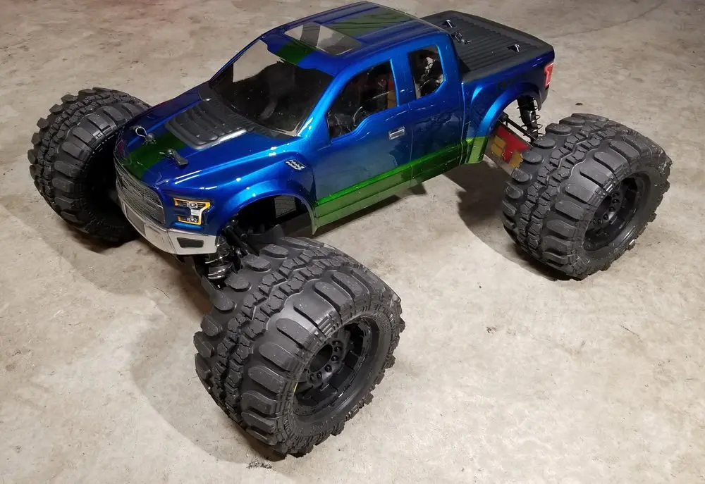

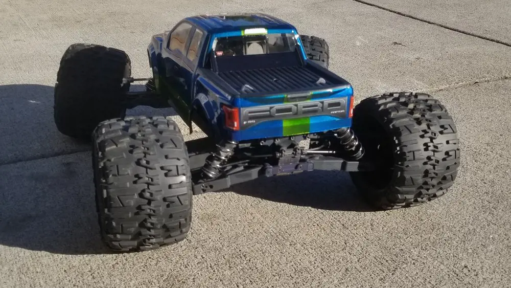

I had custom fit a Chevy Silverado body to my buddies Kraton a while back, so I thought I would try it with mine. Turned out great and pretty much eliminated the need to get the MT410 also...
Looks good. Is that just straight onto the existing body mounts? or was there any modification needed?
Thanks, I moved the rear mounts to the front and flipped them around so they hang off the front the the shock tower, and I put one of the front ones up high in the middle of the rear tower as there is one existing hole there. The small cutouts in the bed I needed for the top of the shock tower stabalizes the sides of the rear body nicely.

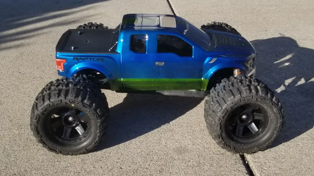

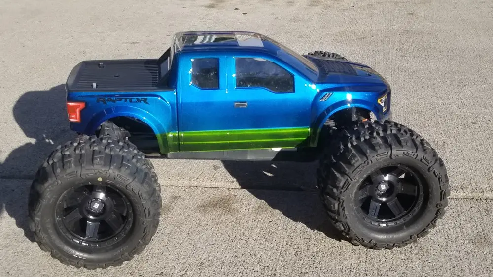

Can we see a side shot to see how short it is at the back axle ...
Yeah I've been running at the track the last few days so I'll switch the mounts/remove the wing and stuff tomorrow if I have time and take some more pictures. It actually doesnt really look short, although the wheelbase is slightly shorter on the body, I tried to split the difference between the front and back as much as possible. If I moved it back any farther I would have had to cut some of the body up front to clear the shocks. The other body I want to try is the Proline GMC Topkick as that is even longer and the wheelbase should be right on. It just looks like the hood has so much downward angle that it might be hard to do the front mounts properly.
it doesn't look bad from your pics but the direct sideways shot i noticed was missing ha ha. i think it looks a bit odd when it's too short but it isn't terrible. Hard to find good longer scale bodies nowadays, HPI makes/made some nice ones for the savage xl that fit the truggy wheelbase great but most are discontinued...
I didnt change the shocks around to raise the rideheight or the switch body mounts so the front is sitting a bit high as its normally pretty even with the chassis, but as far as forward/backwards, this is where the body sits.
