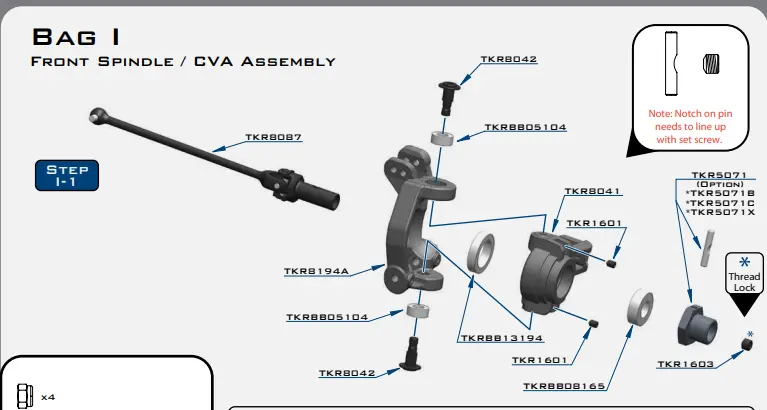

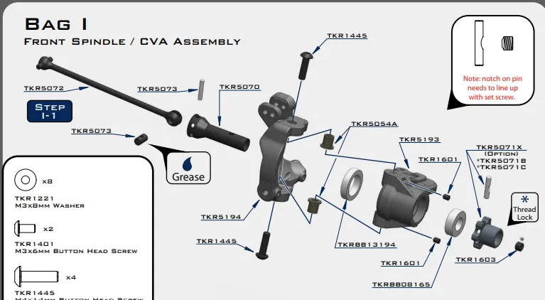

I just purchased an EB48 roller, haven't received it yet. Former owner is not sure which version it is. How do you tell? Also, if it's an EB48.3, what do I need to bring it to EB48.4 specs? Thanks!
The list of updates are posted here:
https://blog.teknorc.com/2016/12/19/new-eb48-4-18th-scale-buggy-from-tekno-rc/
Easiest tell will be the bearing inserts on the spindles and CVD's on the .3 and UNI's on the .4
