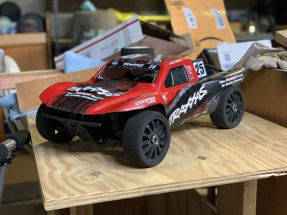

Got a cheap .2 that i'm turning into a basher SCT. Here it is with temporary body and wheels:
