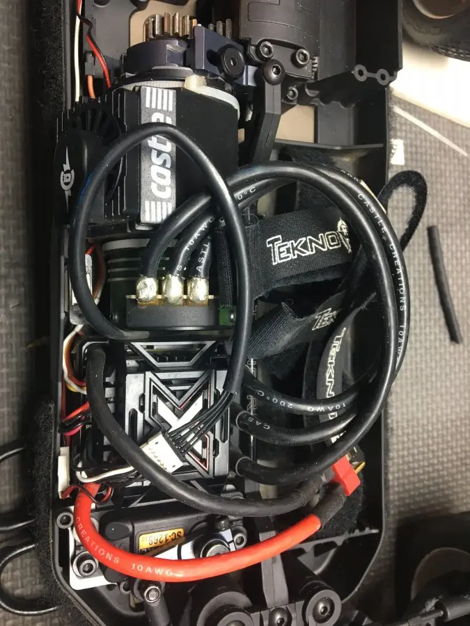

Looking at this picture Overkill posted it doesn’t seem to be enough room for the censored version. Thank you all for your input.
Here is my sensored Castle in a EB48.3, it fits just fine. Get the sensored motor, it’s 100x smoother than the sensorless. Also the MMX esc uses the 3rd channel input so you can turn up or down the power right from your radio as needed.
Thank you for posting this picture. I really want this mmx combo and was sad that it wouldn’t have fit. Now I can order it! Unfortunately everyone is back ordered, but I will be patient.
