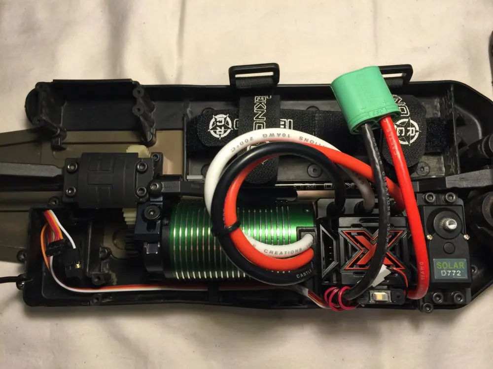

What rig did you have it in? eb48? Snug fit but, still fit with the sensor wire?
Had it both an .3 and and SL. I didn't have the censored version but don't think by memory there would even be room for one.

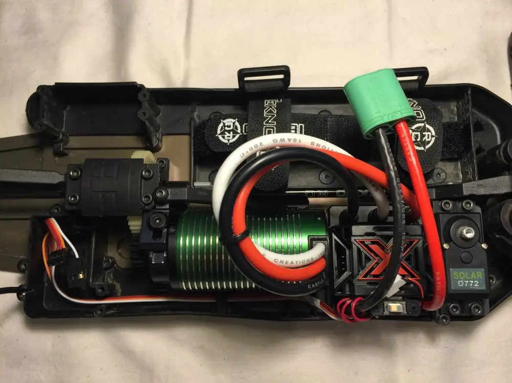

Looking at this picture Overkill posted it doesn’t seem to be enough room for the censored version. Thank you all for your input.
You can turn the esc on its side, but then the fan draws in the heat from the motor
