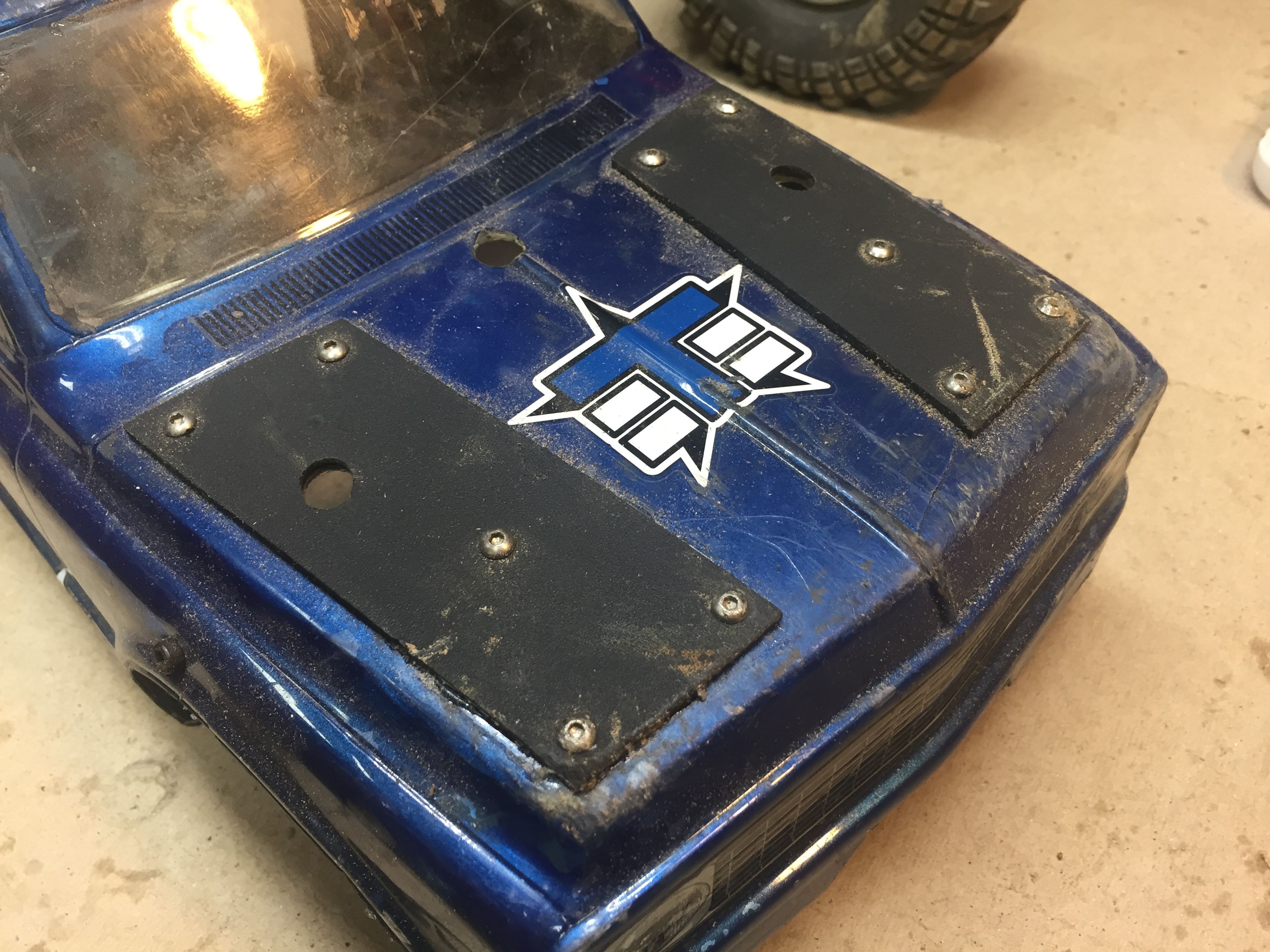

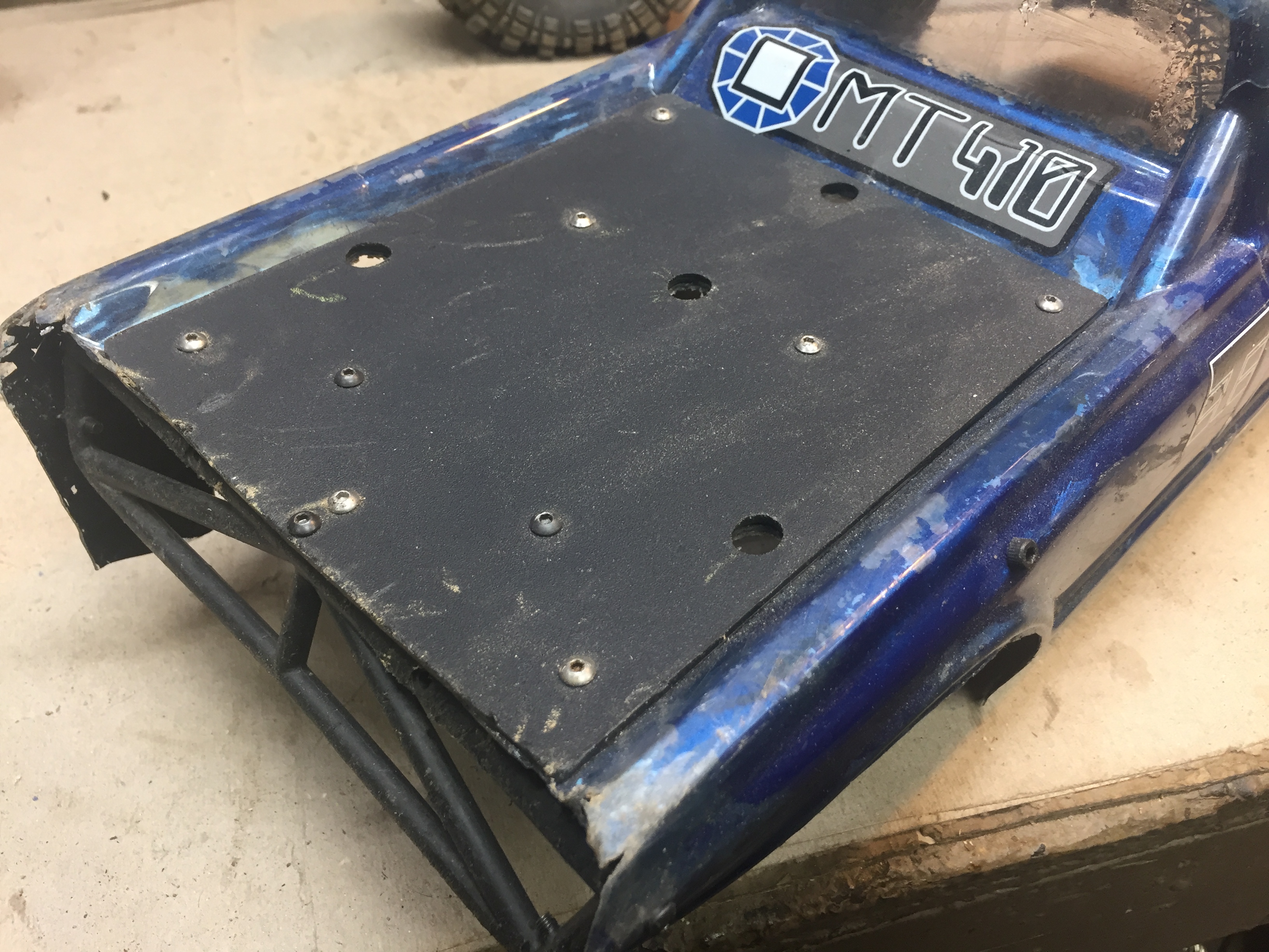

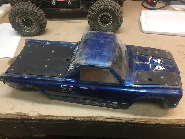

I find the drywall/shoegoo is great for reinforcing and repairing. I’ve also been adding pieces of kydex sheets to bodies for extra strength ...it gets shoe gooed on first then bolted on. Here’s my current MT410 body. It’s extremely durable...been through hell. The whole bed is kydex, also some in front. Also kydex inside strips running the length of the sides(under the drywall shoe goo)
A closer look at the kydex bed.
This has been bulletproof

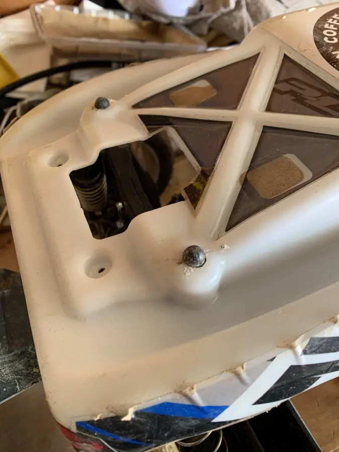

For Overkill durability I have many extra body posts . This way impacts are not just on 4.
And it’s a must to get some body support and posts more toward the center of the body
so really it is a body made from kydex with a touch of lexan. :ROFLMAO:

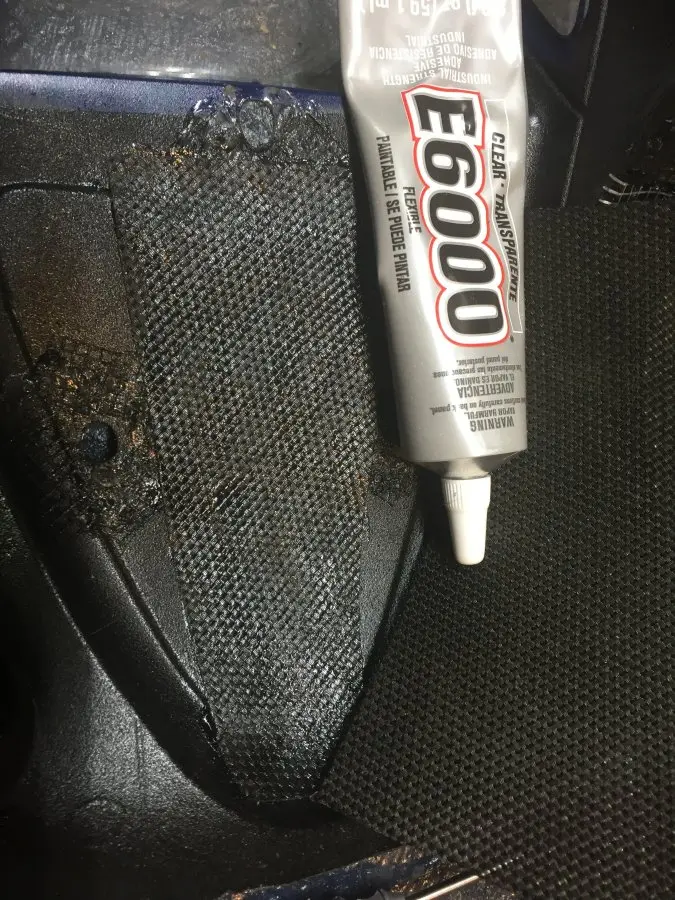

New experiment. Old trampoline material and E6000 glue. Wow this is going to be strong and flexible. Only did a few small sections earlier today.

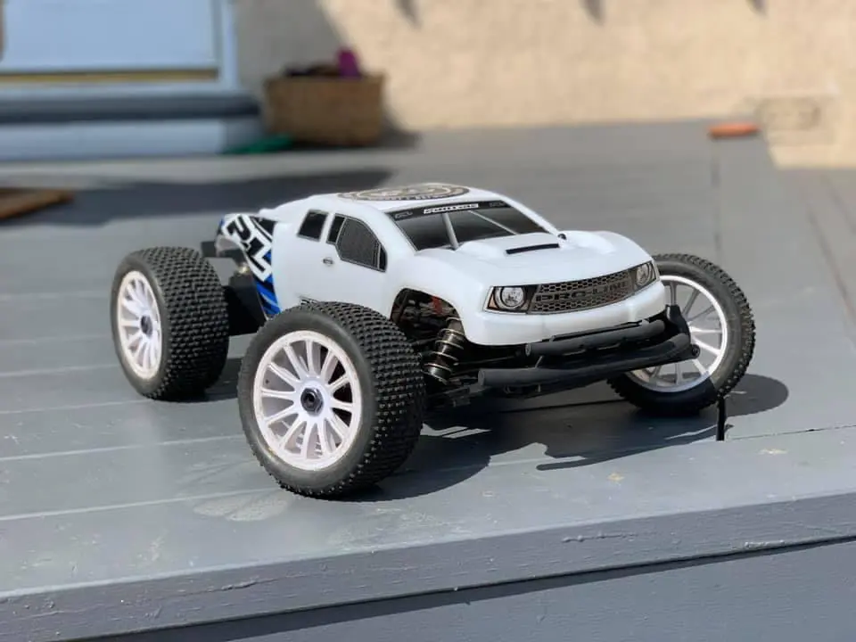

just got the Proline 3530-10 Precut Brute Bash armor body for E-revo for my mt410. The body fits fine but there's a square hole in the back. I gues this is normal for the revo. Any thought on what to do with the square opening in the back of the body?
