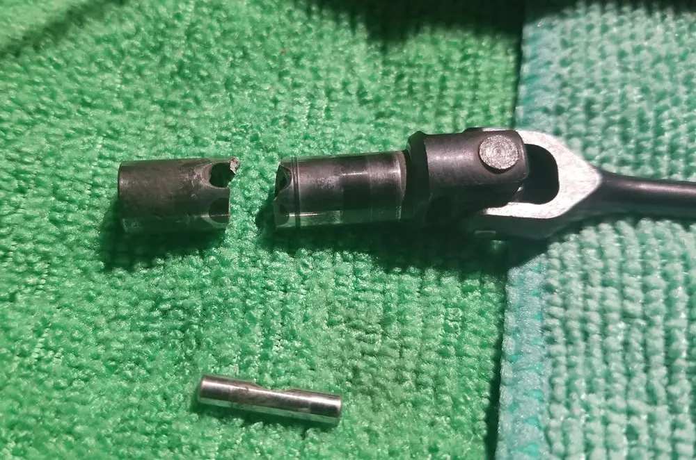

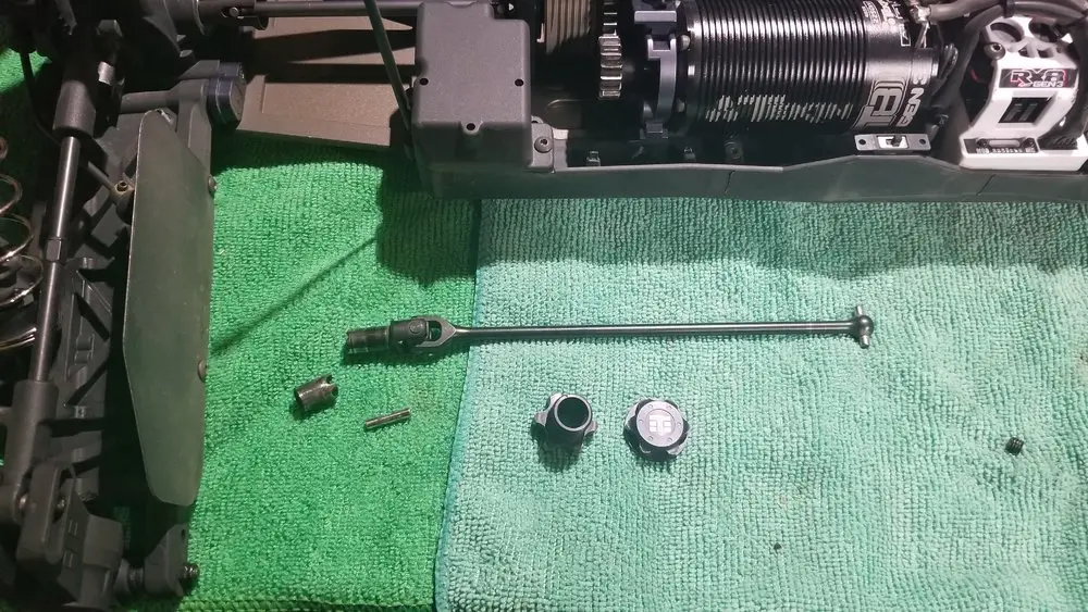

So I had my first casualty with either of my Tekno rigs yesterday at the track with the et48.3. Came down slightly angled and hit with the right rear wheel first from an average size jump and the axle shaft snapped right where the pin goes through for the hub. When I built it last month I bit on the option of the universal shafts, but this seemed to be a weak spot or something. I'm pretty sure they aren't rebuild able and I'm guessing I'll have to shell out another $50.00 for two, but at least I have the stock cvd's I never put in for now... Anyone seen this happen before?

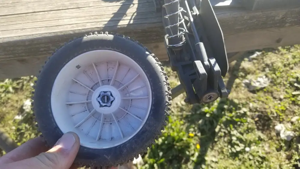

There aren't 2 holes, it just looks like it because of the lightened hub had extra holes so it changed the color of the axle metal where it was touching is my guess. Just one hole, and everything was brand new from amain last month.. mine are just like those new ones in the picture.
Ah, I see now! That picture totally had me fooled! LOL!

That's cool. I sent them a email last night when I got home and tore the car down as they want pictures and stuff. In RC we break stuff. It's the number one frustrating thing about this hobby, especially when we go with big power and high speeds, but I was just sort of surprised that this broke on a landing that my old Tamiya Frog I got in 1989 would have handled. Plus their was no signed at all that it may have cracked or bent somehow earlier, but decided to break when I landed on that wheel first.
