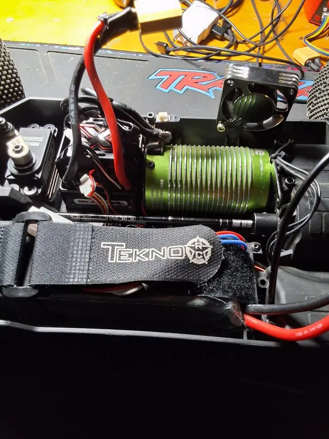

Im planning on running 1/8th scale electronics and changing the axles and hexes to run 1/8th scale wheels and tires. I know the monster X and 2200kv motor fit.
Has anyone converted theirs?.
