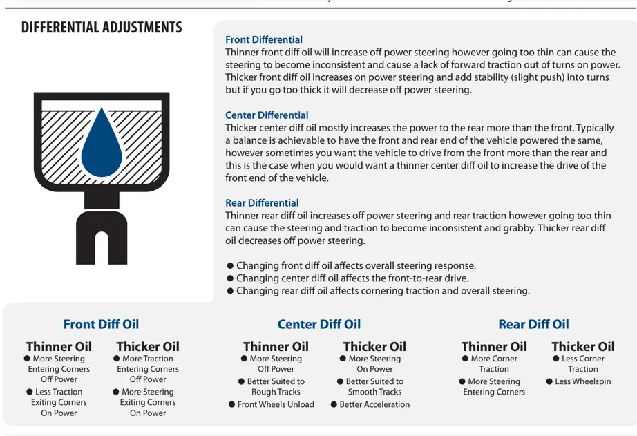

What diff fluid are you running in the rear. A heavier oil in the rear will lock it up more and get that front end to pop up more.
I am running 100,000 / 150,000 / 50,000 in front / center / rear. I understand why the center fluid makes a big difference for wheelies/flips, but i'm puzzled about the rear. Would you mind explaining to a novice?
The thicker the oil the less your diffs will "diff out". To do what you are trying to do you need the wheel to be spinning always not just which ever has the least resistance. If your rear fluid is lighter (like if you were racing) then the as soon one tire lift off the ground the opposite looses grip and will diff out because it has more resistance now, making the car drop back down.
Now you want the opposite. You don't want the rear to loose power when the front lifts up and both rear wheels to be spinning.
Thicker center oil will make the power more even front to back.

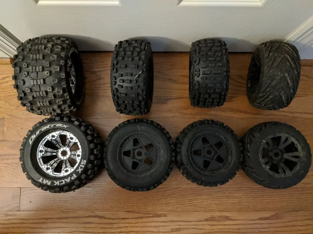

I don't know about the Copperheads, but my general experience (both on grass and in the air) is that you have less backflippiness with smaller/lighter tires. This is, of course, limited by grip as well if you're talking about standing backflips.
The larger the rotational mass, the more of an effect throttle/brake will have on the car. I don't even use my SixPacks anymore because they made the car almost uncontrollably flippy on 4S, and they could do standing backflips on 3S. Here are my tires from most-flippy to least flippy:
- Duratrax Six-pack
- dboots blackflip 6s
- dboots blackflip LP
- minokawa LP
And here there are lined up for a size comparison:
- Duratrax Six-pack
- minokawa LP
