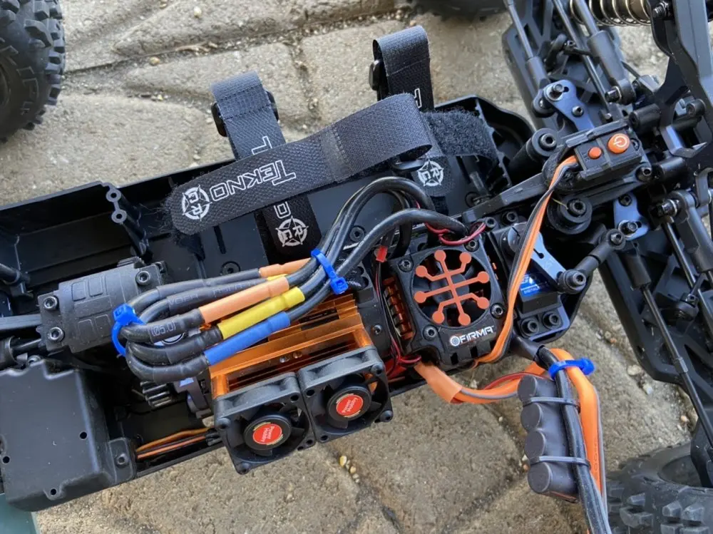

Yes, if you cut the mounting tabs off you can get a BLX185 / Firma 150 to fit:

Thank you for the pic @Engineer! Where did you get that heatsink and fan? Looks awesome! did you have heat issue?
That particular heatsink is the Powerhobby Heat Sink w/ Twin Turbo Fans: https://www.powerhobby.com/powerhobby-heatsink-ph1289blue.html
It's pretty much the same thing as the Yeah Racing twin fan/heatsink as well: https://www.yeahracing.com/heat-sin...ith-around-40-8mm-diameter-ya-0261bk-00033978
They work pretty well although the Spektrum motor is a tad small in diameter so you need to shim it just a bit.
So far no issues with temperature but I'm only running on 4S.
