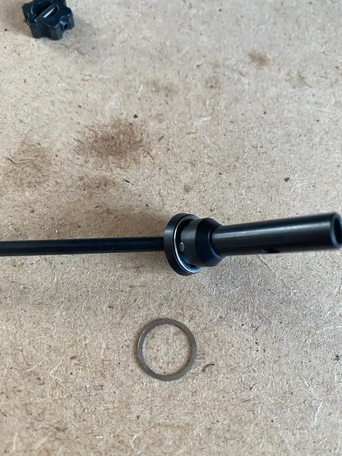

Got my parts in and noticed quite some play towards in the spindles with the TKR5580 stub axels when the wheel hexes were mounted, wondering if anyone else noticed this.
Much more play as with the original axle and hexes. I decided to put on a little shim and this took away the access(imho) play to "exactly" the same amount of play with the original parts. It feels good, hope it lasts while driving ;-)
Hoping to setup and drive later today.
