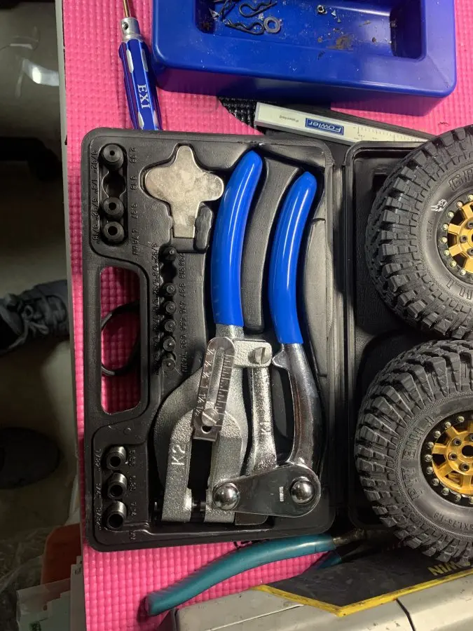

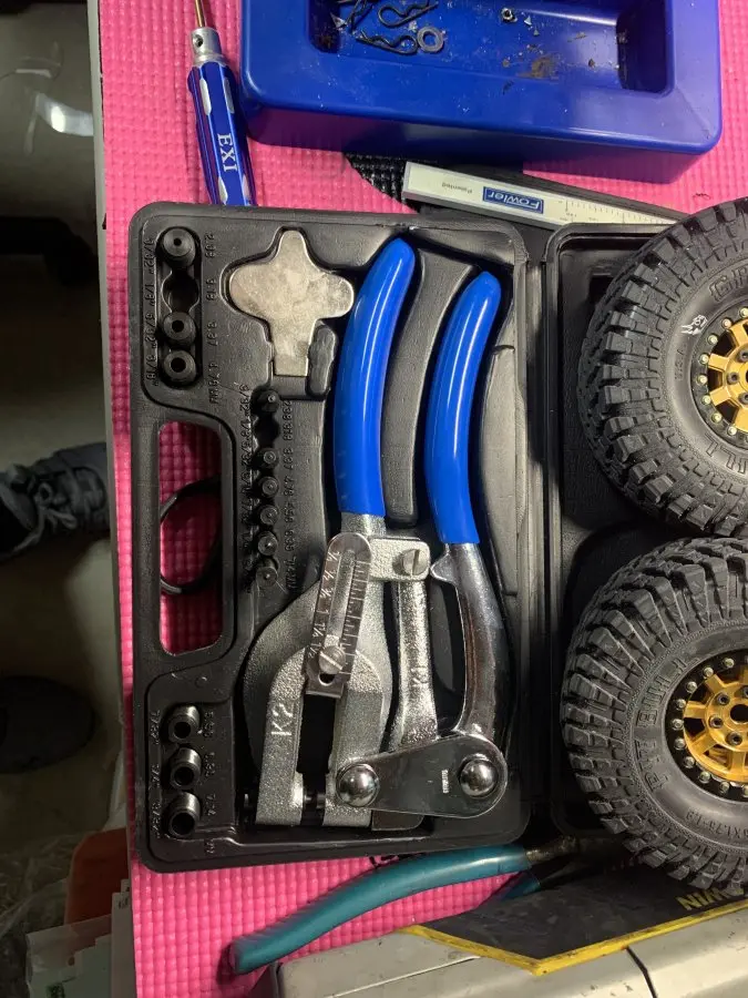

I use a hole punch like this to vent mine before they are mounted.
but I only vent my race/track tires. All my basher tires are non vented wheels and tires just do to I don’t like water and mud getting in the foams. I have had issues with unbalanced wheel ends due to this
I typically do not vent my bashers either, but when I do it (rarely) I've used a punch in the past as well, but I tend to do it a little different, in that I will unglue (if a pre-mounted tire), punch a VERY shallow dip in a tires' bead, an then re-glue to the rim with stronger adhesive to ALMOST all the way around the wheel, leaving about 1mm unglued, (or 2-3mm adjusting for glue spreading). This way, I can slightly vent the tires, but it's on the inside lip of the wheel, an dirt an water have a harder time getting into the foams around the bead. Of course, it makes sure it's much harder for any water to get back OUT, but by that time they may have a very little water in them, they either evaporate, or I've blown out the tires anyway from ballooning or just plain worn out. If I'm being really OCD on those instances, I will balance the tires an add a drop of glue here or there where needed inside the wheel nearest the hub.

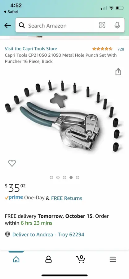

I want to ask is there a name for this type of hole puncher I can't find one that opens wide enough to do my tires thank I appreciate it.
Sorry I don’t know how to attach the link
But this is like the one my wife has and it works great
