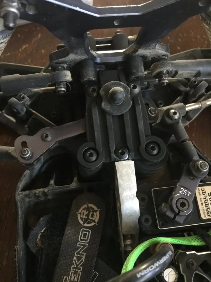

What kinda arm you got? Let's see a pic
[GALLERY=media, 113][/GALLERY]
Tekno aluminium one.
oh then the arm probably isn't the issue but it does look a little off center, does the arm hit your ESC when you turn full right?
I'd also try to disconnect the arm from the servo and move it manually, see if there is any binding / check if the full range of motion is there... that should tell you where the problem lies... if the servo just isn't moving the arm far enough maybe it is the servo or your EPA is turned way down on the radio.
It needs to be like this to have the wheel more or less centered when it's in the neutral position. Seems to be similar to other's cars pictures and the manual. It's not perfect though, the exact position falls right in the middle of two of the 25 grooves.

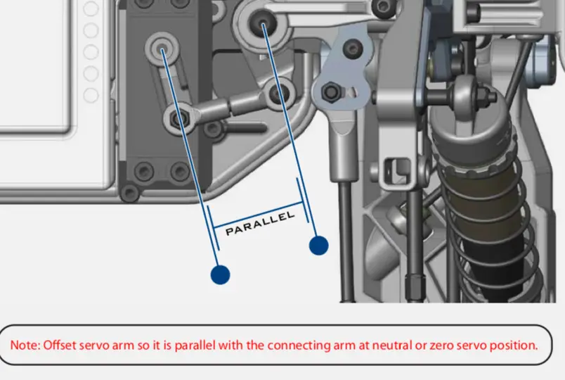

What I meant by your arm off center is that it doesnt look parallel to your linkage horn, I know it isn't supposed to be centered with the servo. Weird, well I'm not a savox fan, maybe that's it.
Oh yeah, that, right.
I tried changing the length of the link to make it parallel, and as expected, it turns better in one direction, and worse in the other then :ROFLMAO:
I'm going to try my PowerHD crawler servo and see it if helps. It's just a bit slower / less strong, but barely.

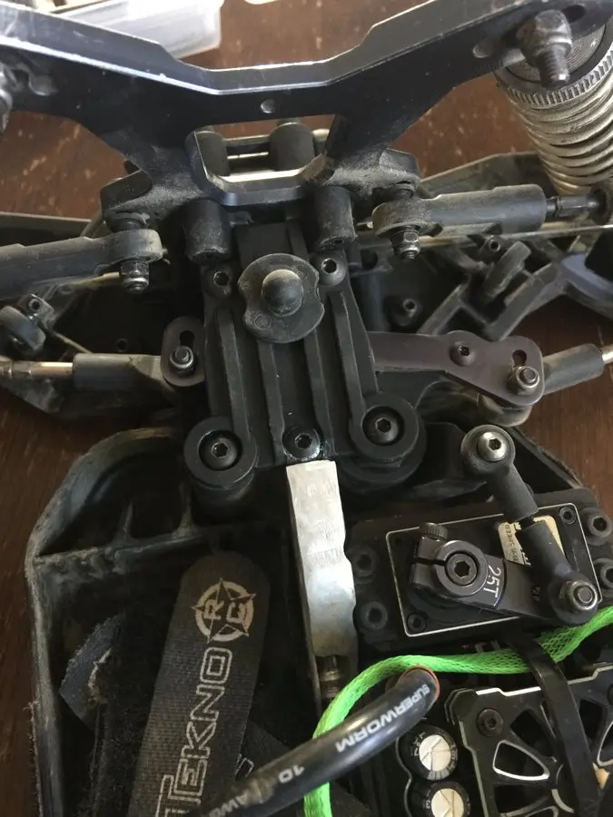

Can you post a pic of the same area as pic above but showing where it stops when turning?
You do have to get the servo horn and the arm parallel.

I think something is off...I have never seen someone requiring a larger servo horn to get the proper steering on these Tekno vehicle. The .4 steering you have in the MT is the same geometry they use in their .4 buggy. It also can be an upgrade to their ET48.3 and the SCT410.3/EBSL.
These pics are of my buggy but its the same steering assembly as yours. At full swing it should like this;
To the left;
To the right;
So you still cannot replicate the steering limits you see in my pics using your controller and the stock horn?
Perhaps its time you do a tear down to make sure everything is operating correctly without a servo. Without pics showing your car (with the problem in action) we are all going by the translations we think are the problem through words...not always the most accurate way to explain these sort of situations IMO.
We are struggling to get you a solution, I think because there is still a piece to the puzzle that is still not getting relayed.
The range I see is nothing like your pictures, and not because it's hitting the limiters either...
