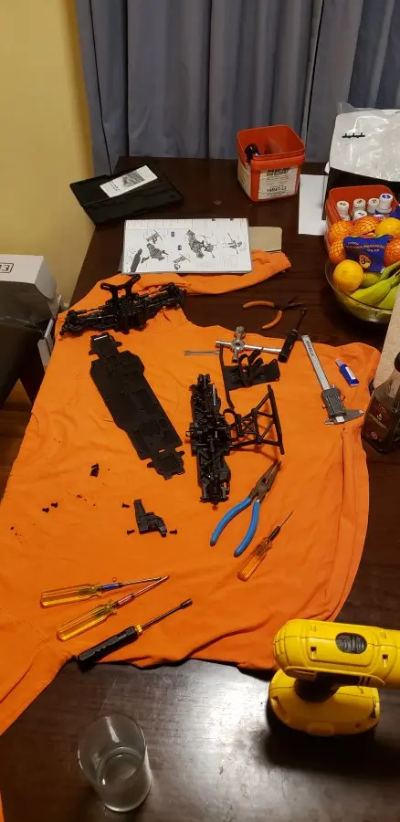

I've spent the year of 2020 talking myself out of buying the 410.3, back and forth i went. I would decide im going to do it and they would be out of stock, check back later and it would be in stock but I was gun shy. Finally last weekend I checked, tekno had the 410.3 in stock, I closed my eyes and hit the purchase button! So, fellow addicts, I ask you this. What better way to spend a long holiday weekend than building a fresh new tekno kit with your son? This build will be a replacement for my frankenslash, which finally needed a complete tear down, new chassis and a slew of replacement parts. I figured it would cost about the same to get it back to functional as buying the tekno kit. Might be crazy logic but it works for me and the wife bought off on it. Delivered yesterday, build starts Friday. It will run the electronics from the frankenslash, castle 1800kv, max8 and servo I can't recall at the moment. She will run 3s. Lets hope my son and myself survive this build!

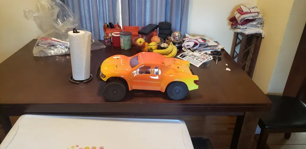

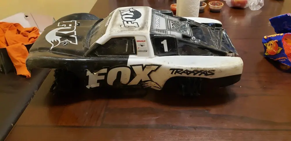

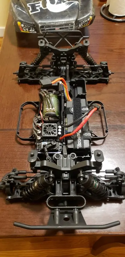

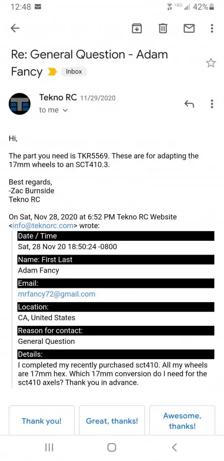

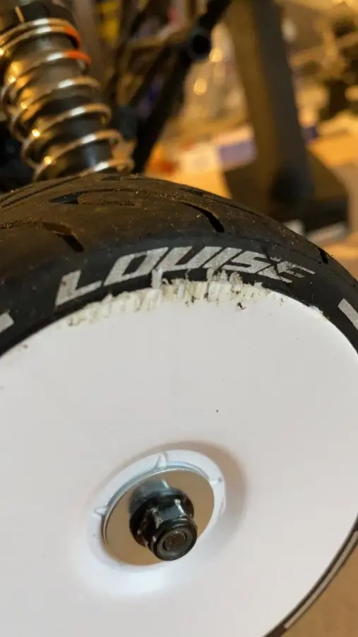

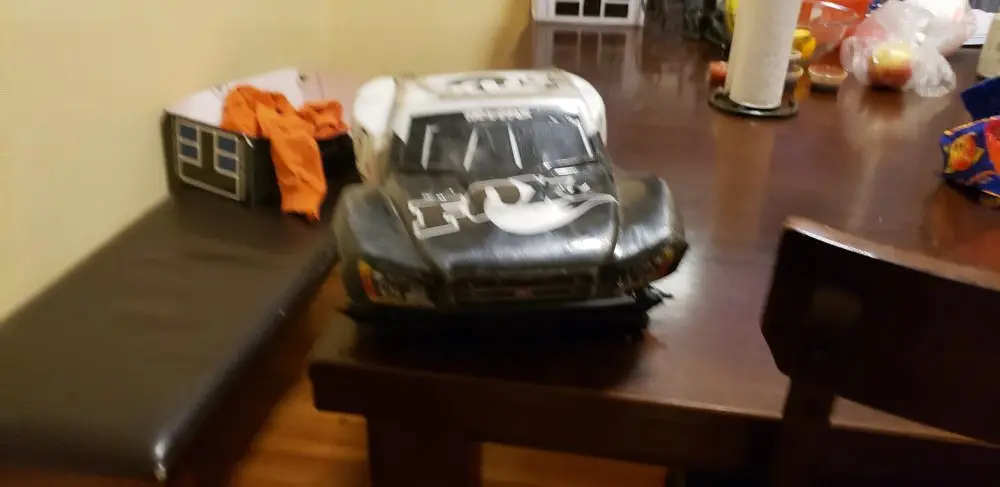

Truck got finished Saturday, electronics got transfered over Saturday afternoon. I made one booboo though, all my wheels are 17mm! So after centering the protek servo, calibrating the max 8 and doing a quick test on the bench to make sure everything works i emailed tekno to find out the appropriate 17mm conversion for the truck. They answered sunday and parts were ordered and shipped today. I have multiple sct bodies to choose from, but the fox body (as weathered as it is) is one of my favorites. So I wrapped a tekno in a traxxas shell, ha!

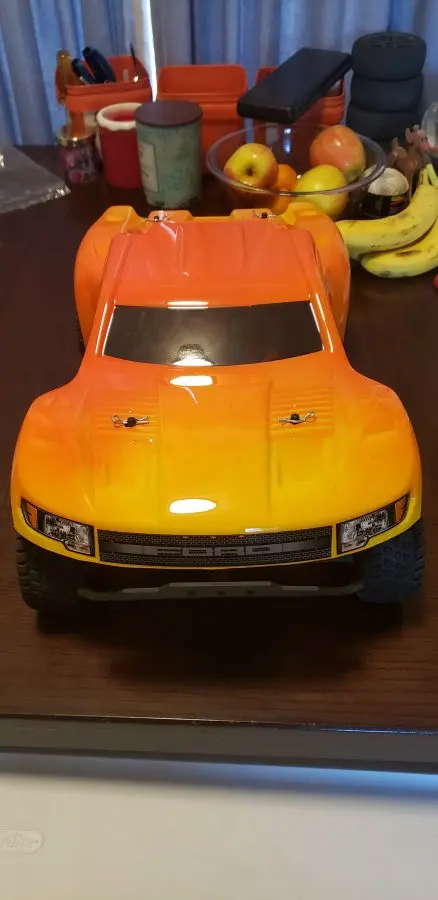

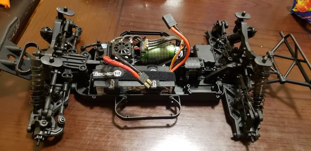

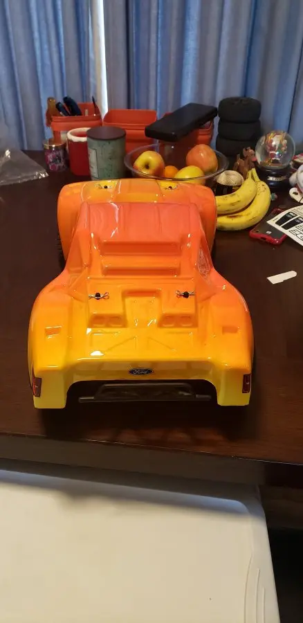

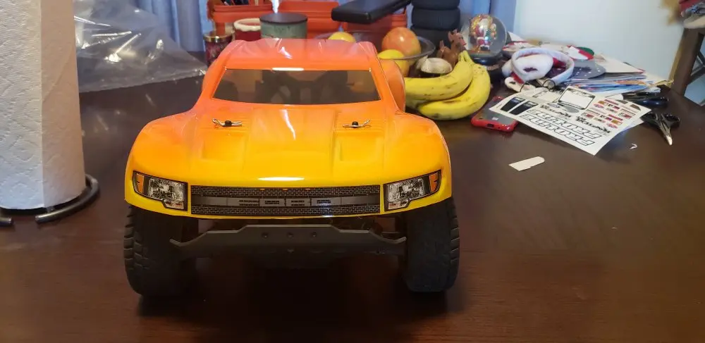

17mm conversion installed, I purchased the appropriate hexes to keep the track. We ran it a few times so far. I geared it with a 25 tooth pinion and the castle 1512 1800kv is ice cold. While its not the fastest rig we have it is enjoyable! The handling is night and day from a slash! I can gear up or run 4s, haven't decided yet. Couple goodies came in, the t bone basher front bumper and I found a raptor body in the shed that needed painting. Final product....

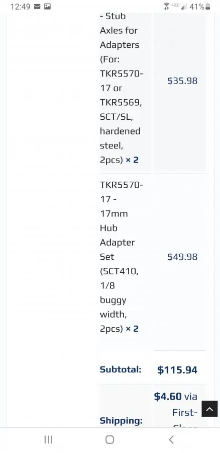

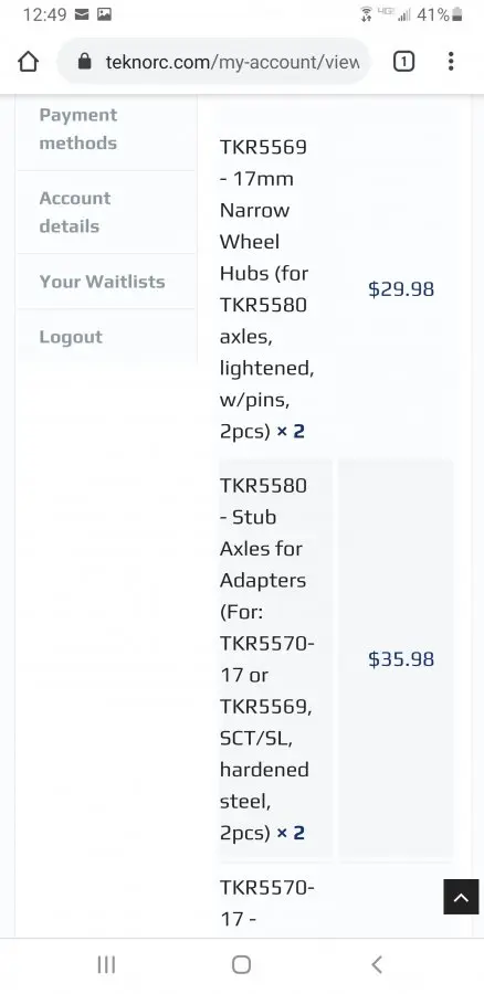

Hello vingertop,
I'll attach screenshots of my email with tekno and my invoice with tekno. Teknos response directed me to one part number but research showed I needed a little more. Let me know if you have more questions.
