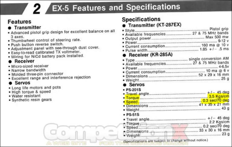

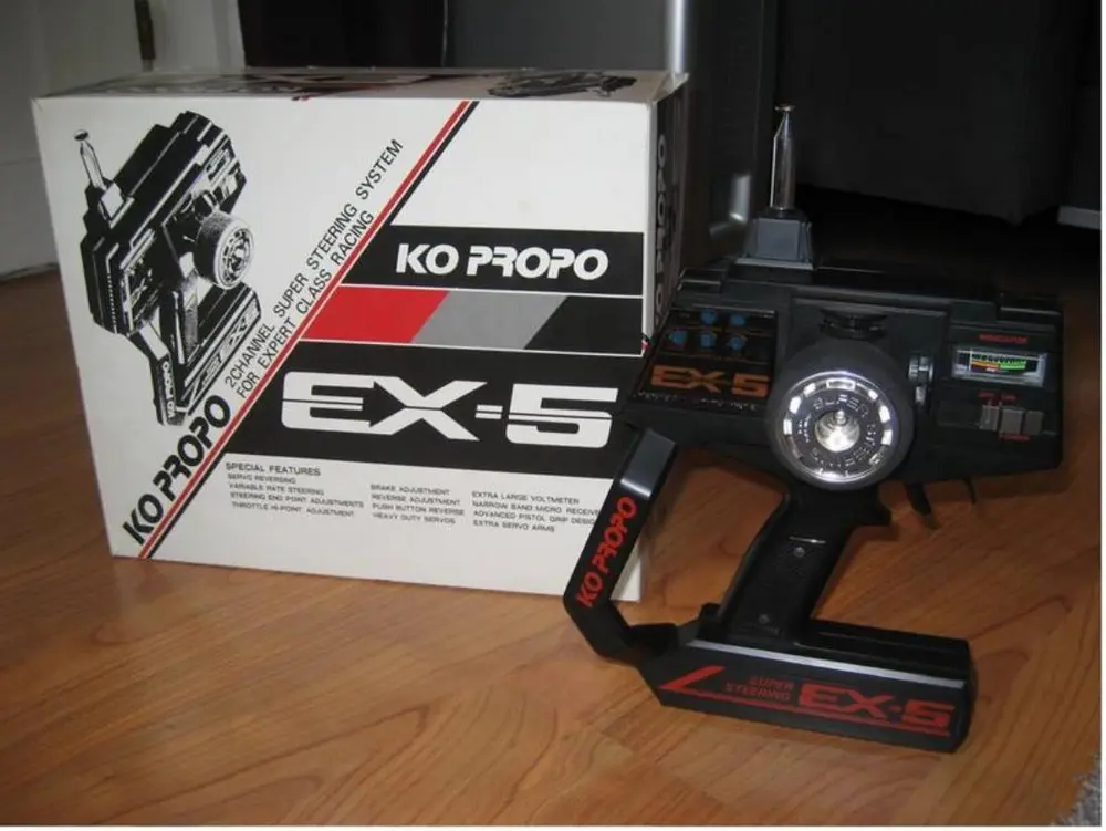

Age game: who remembers servo(s) included with the radio/receiver package?:p
The last radio package, that I can remember coming with servos, was my KO PROPO EX-5 (1990-ish?) with two PS-201S servos :LOL:. Check the servo's speed/torque specs out:
