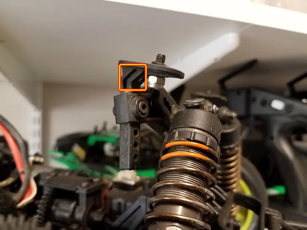

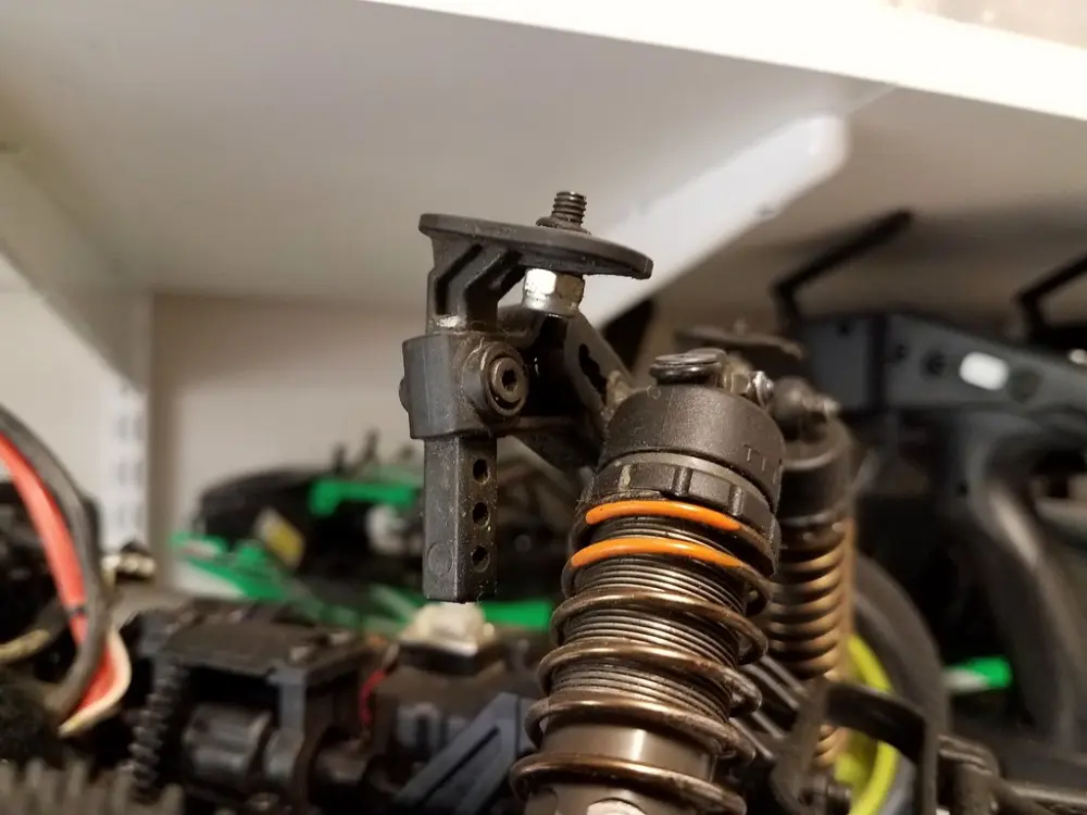

I have done this with limited success, eventually the threaded set screws will strip out of the drilled body posts because there is a void in the backing of the plastic which is hollow in the center... the ProLine mounts were solid plastic and the threads didn't strip. Shoe Goo will help secure the set screws into the drilled body posts to extend the time before they fail.
another option is to back the set screw with a nut:
Good Luck!
Good Luck!
Now you have my wheels turning… I think a trip to the hardware store is in order. Right sized studs for the thumb screws and nuts on both sides of the mount?
Good Luck!
This section of the body mount is hollow inside?
No, I was referencing how thin the barbs are and the need to back the set screw with a nylock nut.
