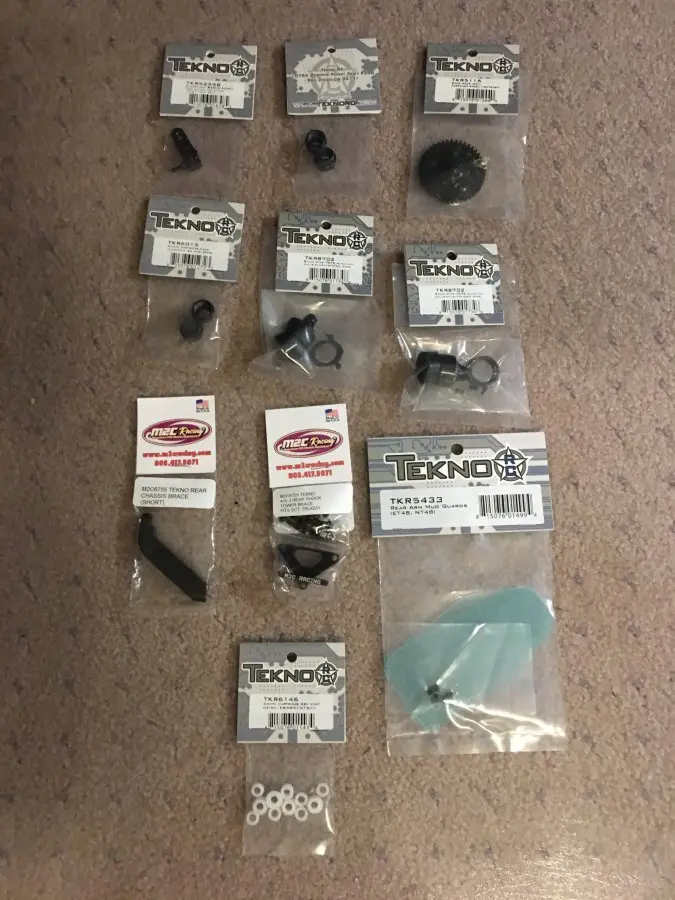

Here is my start. Going backwards parts then kit.

I have pulled the trigger. I have finished collecting upgrade parts and have purchased my MT410. It is back ordered so it will not be here for a couple of weeks.
