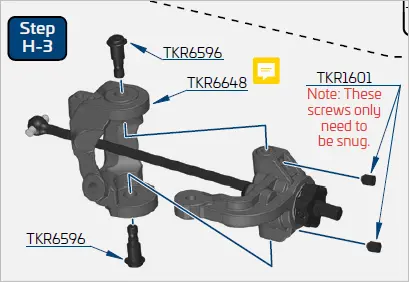

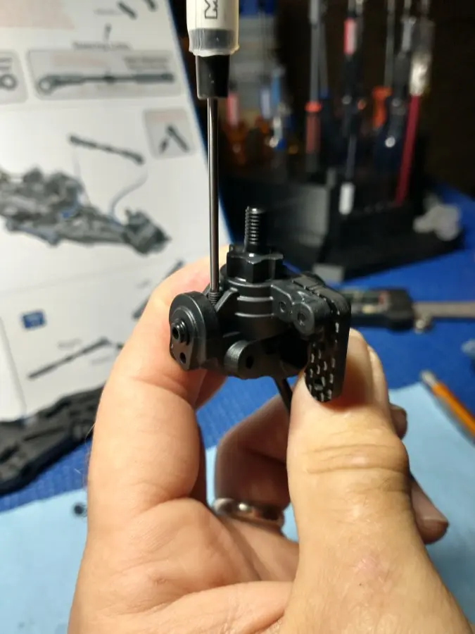

Those set screws, that secure the kingpin shoulder screws, require a delicate touch. Very easy to strip the plastic. To better feel them snugging down, I semi pre thread the spindles. I insert them 3/4 of the way in, then back them out a bit before finishing snugging them down with only thumb and index finger on hex driver handle.
Speaking of spindles, I always keep spare kingpin shoulder screws on hand.
