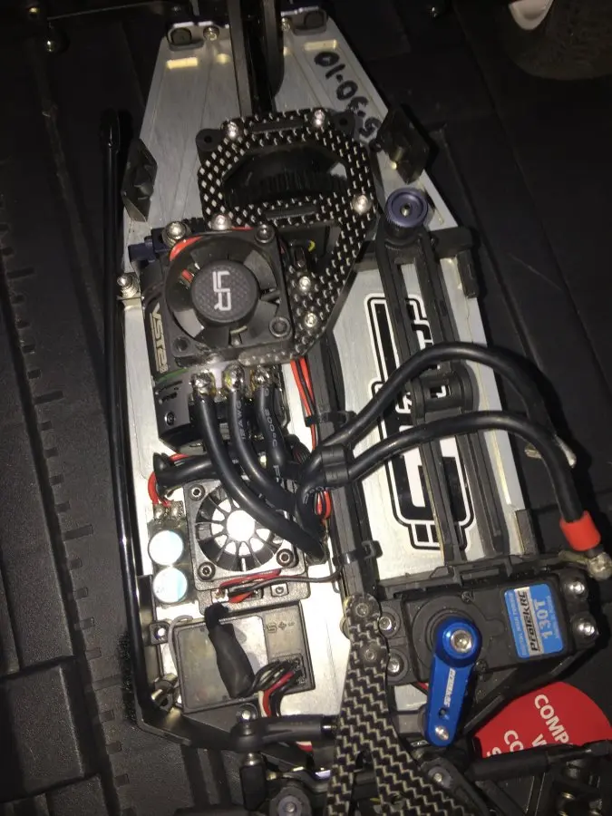

I have also been able to mount them on the side of the ESC. (this is actually an ET, but has the same electronics layout as the EB)
