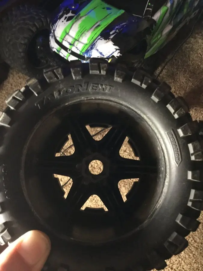

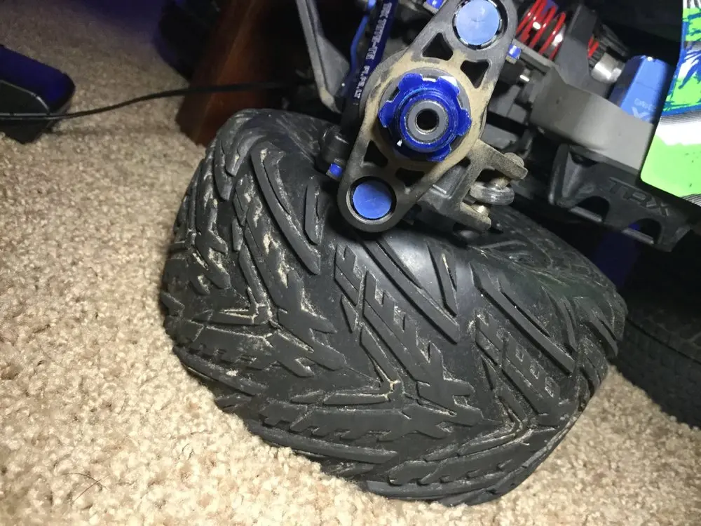

Traxxas makes their wheels so they cannot be swapped to other cars they have a different 17mm design. I removed one to show the notches

I just tried it. IT WILL NOT FIT. the wheel from a 2.0 has the notches and will not go on a standard 17mm hex. look at the pic I posted of the wheel and you can see why it will not fit

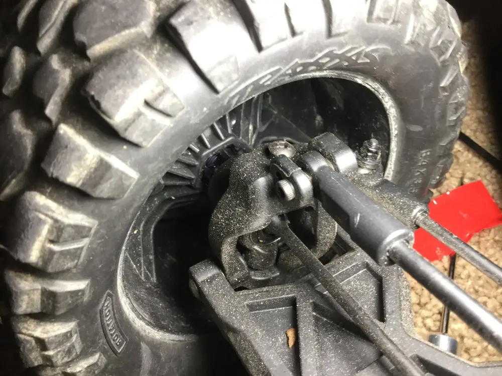

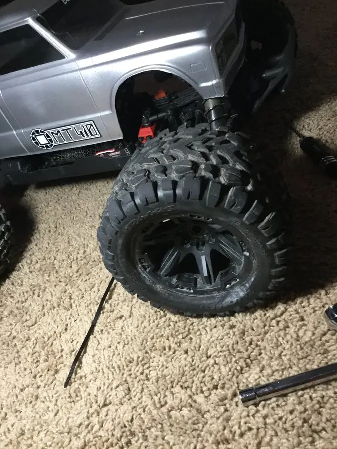

And look at the picture I attached, that shows the Talon wheels on my MT410
you have to Dremel out the tabs inside of the 17mm wheel to make it fit on others. a simple google search will prove that they do not fit and I just wasted 5 min of my time trying it.
Traxxas only wants their wheels to work on their vehicles and the hubs match I’m looking at them in front of me. He could put the tires on a different wheel or dremel out the stock tabs. I’m a mechanical engineer btw so I’m confident and if you have any common sense you would see why it doesnt work. It’s like the square peg in a round hole. They were smart enough to make it where a standard wheel fits onto it but a Traxxas wheel is keyed to only fit their hubs look it up

Again, I personally put the talon wheels from my 2.0 on my mt410, without any modifications! I don't know why you don't believe me, or why you think I'm misleading. Mechanical engineer is great, but, they would figure out how to get the square peg in the round hole. Please hold until I get home, I will show pictures of your impossible feet being done

Passionate conversation, not arguing, ha. Maybe my brand new wheels were already modified. I don't know, all I'm saying is the talon ext wheels and tires came straight off my erevo 2.0 and went directly on to my factory spec kit built mt410. No modifications, nothing but loosening the wheel nuts, swapping tires and tightening wheel nuts.

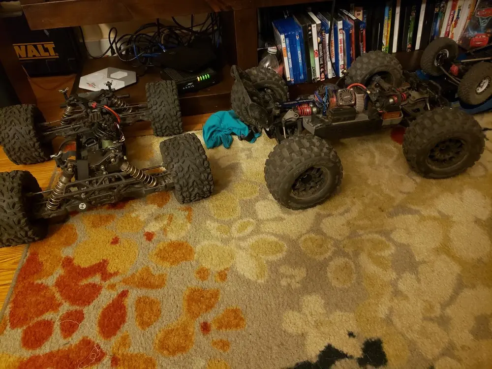

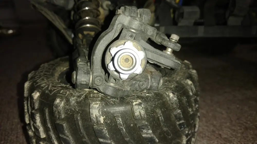

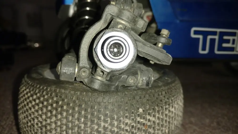

Are you guys comparing the same vehicles and hexes? My MT has star hexes, the ET48.3 and EB48.4 have the full sized ones, at least on mine. And all parts are stock on all mine.
