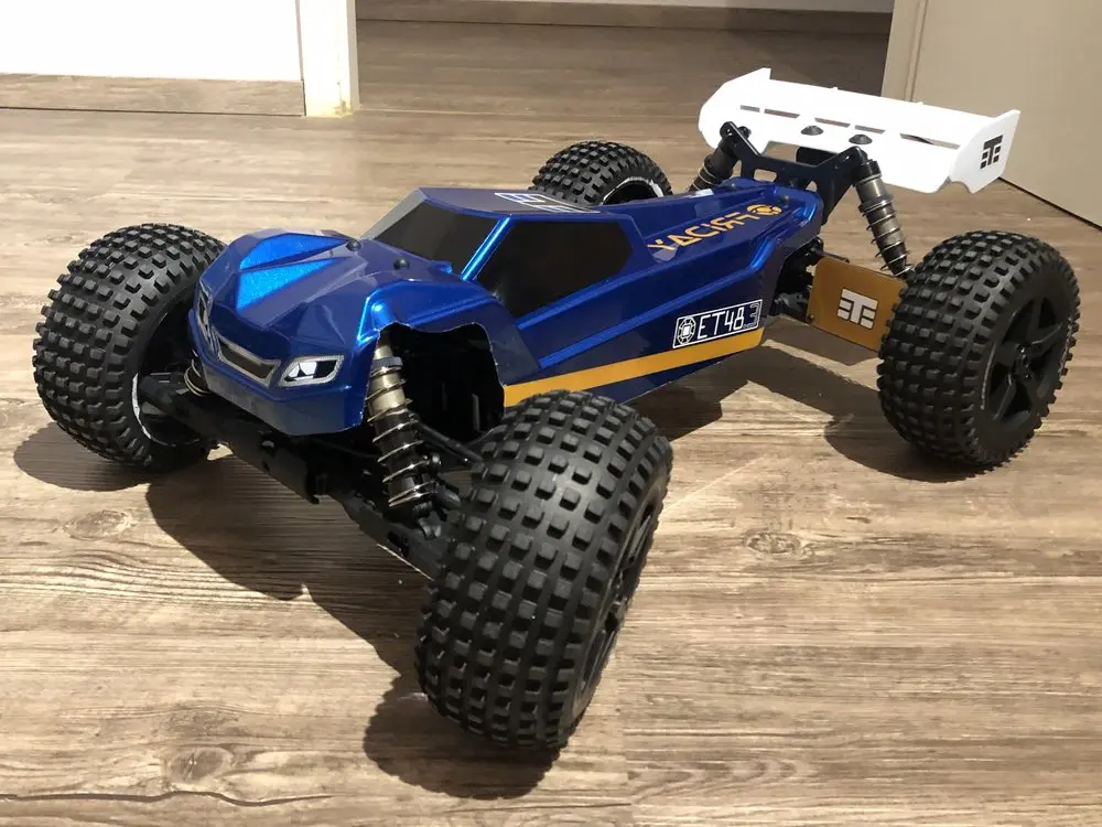

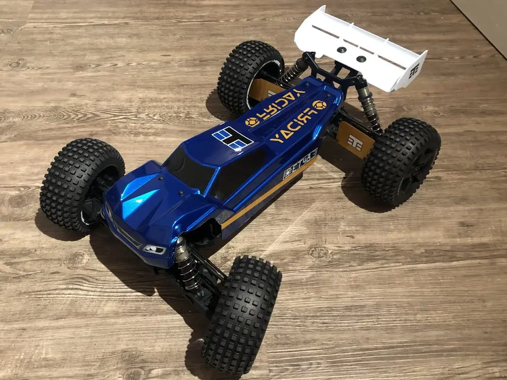

Hey all,
After reading in this forum for a while, I decided to go for a Tekno ET48.3 - and this thing is freaking crazy! :)
It was my first Kit ever built. Everything was really well explained in the manual.

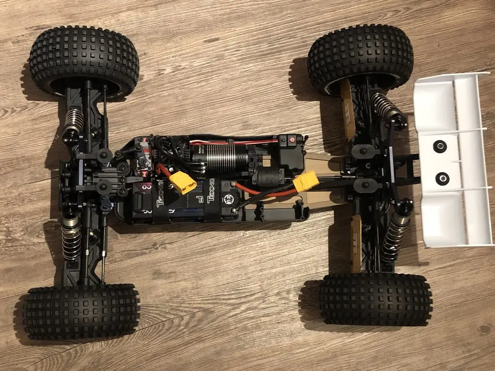

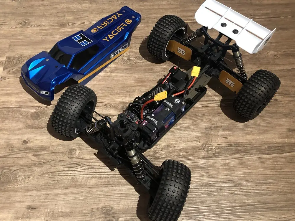

I decided to go for a hobbywing XR8 plus - 2250kV Motor combo with a t15 pinion. And here it is:
Regards,
Christian

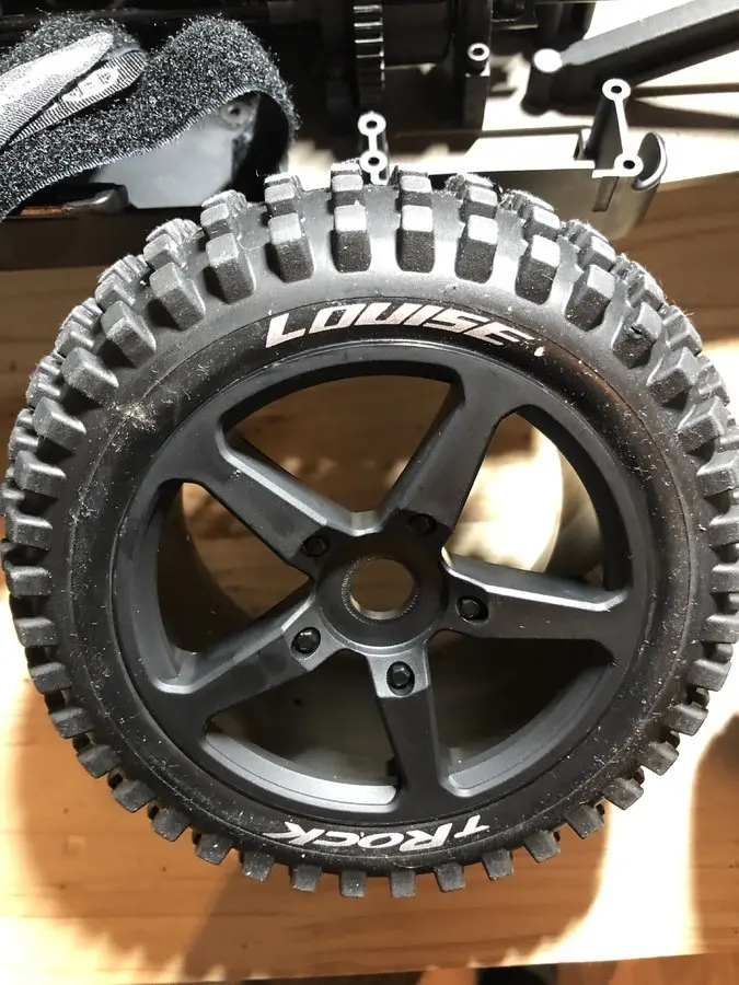

Looks very good! What tires are those?
Tires are the Louise TRock (there are two versions one for Buggy and one for Truggy). They are really good for off-road bashing and they have 0mm Offset - so you can mount them without modifications.
They even come in two flavours, hard compound with normal foam and soft compound with closed cell.

Excellent work! Working on ET 48.3 too...almost done! Love the color scheme! What color and brand of paint did u use (blue and orange)? Thanks!
