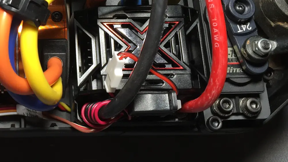

Trying to wrap up the few problems with my build. How do you make the castle on/off switch stay in place. I tried double stick and Velcro.
Do it like contact cement? Glue both surfaces dry till tacky. Then press together.
a lot of folks just cut the switch off and solder the leads together so it's always on. i use double sided tape but it likes to come loose sometimes, i've been meaning to mount it somewhere that i can use the two small screw holes that are on each side of it, it would be nice to have it flush mounted somewhere and screwed in for a nice clean look... not sure where though, not many (any?) places.
I use 3M VHB tape and have never had it come loose.
Yeah let them sit for a minute then press together will make a solid joint but will also be remove with some force
