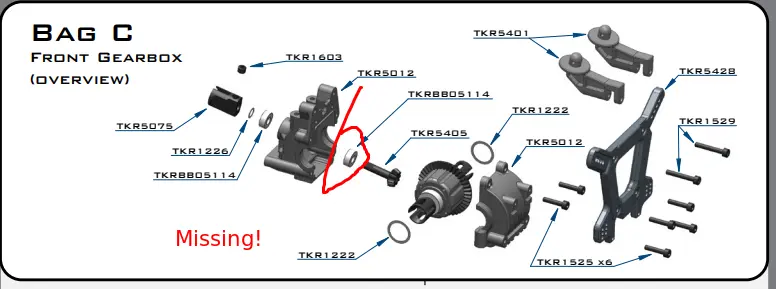

Yep, I found them, they are fine, however the outdrive on the front differential appears to be busted inside somewhere, it has about an 1/8 of play in and out and I can move it side to side about a 1/4 of an inch. Would have to be the front diff, and not the rear > : |

I've got it apart, i'm assuming there is supposed to be oil in the front diff case, there wasn't, just a little bit of sludge, I guess old grease.....
According to the manual, looks like just grease?
Anyway, it appears one of the bearings was either never put back in, or it disintegrated, there is only 1 bearing, I guess thats why I could pull the diff pinion shaft out 1/8-1/4"
My bad, i'm looking at the front gear case, not the differential case... guess just grease. Ok, guess I just need some bearings.
yeah there should be 1 bearing on each side of the diff case, typically there should be diff fluid filled in the sealed diff case, I would inspect the rubber seals and replace if there are any tears, you want to use grease on the rubber seals only, this will prevent the diff fluid from leaking ;)
More than likely it has been a very long time since the diff was properly serviced (normally want to rebuild the diffs every 25 battery pack cycles) and once the fluid leaked out, then you started to cook the diffs which generated excessive heat which in turn blew out the bearings... might want to inspect for any melted plastic and replace those parts as well.
It's the front gear case that's missing a bearing for the diff pinion. The diff I think is fine. My bad, I said diff, I was looking at the gear case.

Might have disintegrated, did see some curled up thin pieces of metal/plastic inside gear case.
I was once recommended to glue that bearing in the casing.
The problem is that the casing doesn’t properly hold the bearing in that spot. While the gear pinion gives the bearing enough slope to dislodge itself. That’s when the bearing gets destroyed by the torque that gets applied on it while not supported properly.
There is a bit of personal interpretation of what’s happening here, but it feels right. Will keep the group posted on further findings.
By gluing, i would suggest three glue points to keep the bearing in that spot holding to the casing and still be able to pop it out if needed.
I've never had to glue a bearing under any circumstance... what can happen is if you don't properly maintain your bearings, void of grease the bearings can over heat and melt the plastic ever so slightly which can damage the gear box, it will be very subtle but can cause bad mesh with the diff case and pinion gear. If you feel the need to glue a bearing, then chances are the diff case needs to be replaced instead :)
Old grease breaks down within 20-25 battery pack cycles and needs to be flushed out... fresh grease should be applied and that will ensure your plastics will last a lifetime... I am still running the original gear boxes on my SCT410.1 which is approaching 9 years old... the key is regular bearing maintenance ;)
It could totally be a bad fix for an already worn out casing... objection accepted! ?
