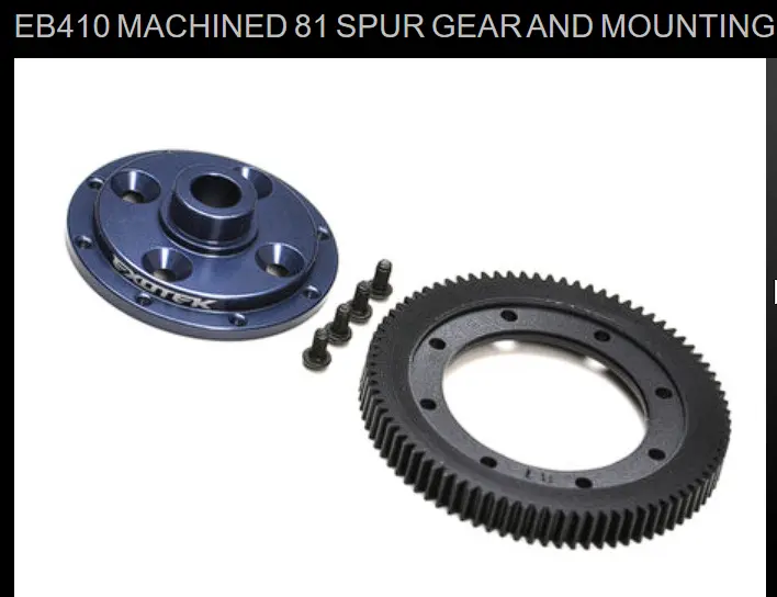

Is there a metal spur gear made for the eb410.2 The composite ones aren’t lasting on rough rocky tracks in New England. If you can point one out or show what you have working it would be much appreciated.
I'm not aware of a metal one but I switched to this from Exotek so you don't have to open the diff to change the gear.
@Dogwood another option might be using one of Dusty Motors (dustymotors.com) mesh chassis covers to keep the rock and debris out of the chassis.
I would also suggest trying the 32 pitch gears. Exotek also sells a 2-piece spur gear in 32 pitch.

Yeah, I'm not seeing Exotek's 32P gear for their diff mounting plate. Discontinued and sold out at the first handful of places I checked.
