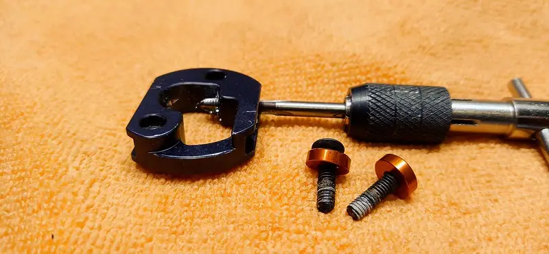

If you are using lots of thread lock in the motor mount, I have found that it dries up in the hole and prevents the screw from properly fastening the mount. I've had to drill and tap the hole all the way through so that the old thread lock is pushed out the other end. Another option is to melt the thread lock with a micro-torch when setting the mesh and that will keep it nice and tight.

I noticed on my SCT410 2.0 that although the gear mesh motor mount adjustment would stay locked in place, thanks to the red threadlock I was using, the motor mount itself, secured by the countersunk screws on the chassis came loose a few times, which stripped the spur gear.
The fix for this was to make sure that the screws were all cleaned with isopropyl alcohol, then I cleaned the threads in the motor mount using a cotton bud before finally using plenty of red threadlock to secure the screws. This fixed the problem and I haven’t stripped a spur gear since.
