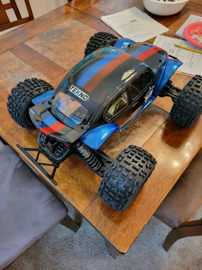

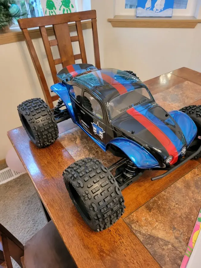

Thanks! It was a spur of the moment thing actually. I had bought the body quite a while ago for my TC Kronos xtr, which came with 2 bodies..still on the original. Was trying to figure out what to use on the MT48.3 when it hit me..duh!! Right now the Mojave mounts are only secured by one screw each, I'll probably use some aluminum bits to triangulate them to the shock towers. But yeah, it's a near perfect fit and once I had seen that punisher body I had to have it! LOL

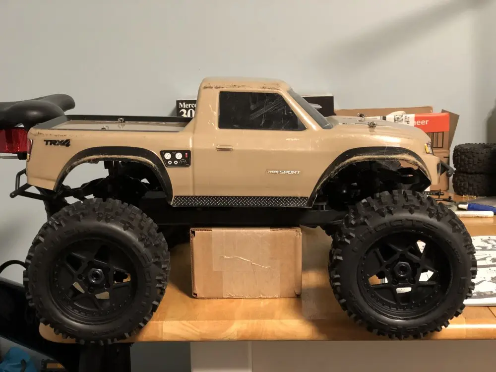

TRX-4 bodies work perfectly and they are really strong.

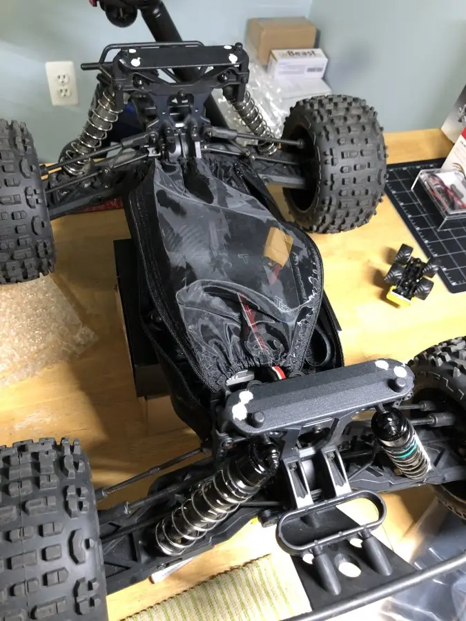

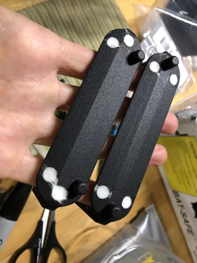

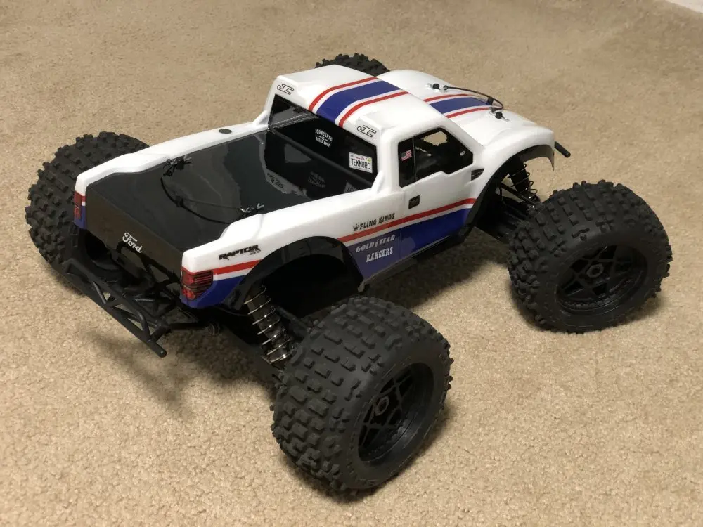

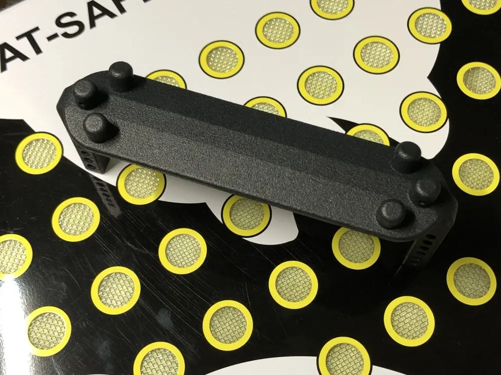

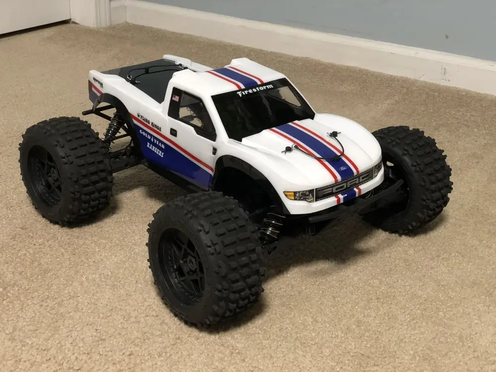

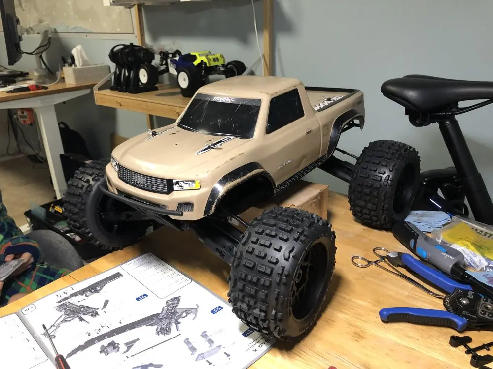

I found out while waiting for my 3D printed custom body posts to arrive for the real body, the J Concepts JCO0274 2010 Ford Raptor.

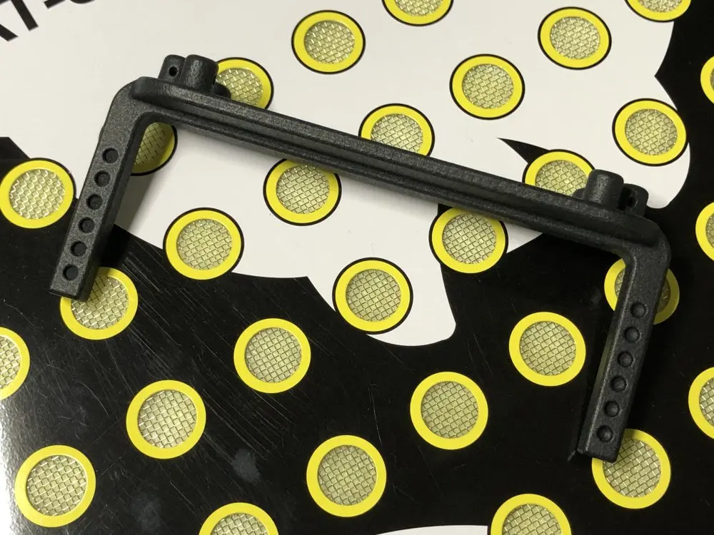

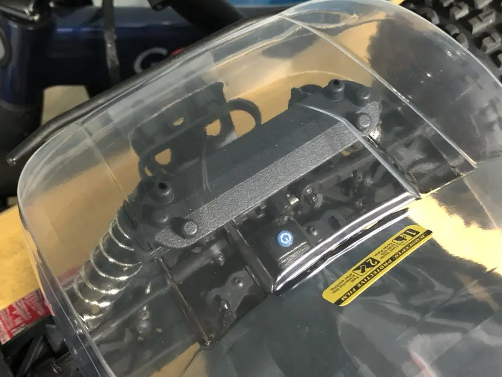

The Raptor body is the right size for the truck, but the stock body posts land in a bad spot. I really like the race truck vibes of this body, so I designed some stronger body posts and had them SLS 3D printed by Xometry.
They have 3 angle options (0, 8, and 15deg) so you just test fit the body and saw off the posts you don’t need.
Also they connect the right and left hand side so strength is greatly improved.
So far so good! Everything fits as expected. If anyone wants the 3D data for these posts I can put it on GrabCAD.

Those posts are awesome, let us know how much they last.

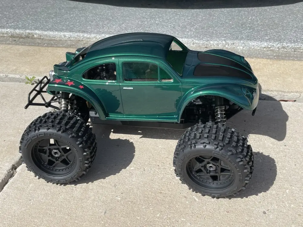

@Ferrebee88 The Baja body ↑ turned out really boss! Awesome paint job there. I like it a lot.

Nice work!! Both bodies fit nicely, I do prefer the look of the proline body but think it's more the paint job TBH. That's awesome that you can design those parts!! I have printers but no clue when it comes to CAD!! I wish I knew it..
The 3D printed posts are working well, but I did break one on a very hard rear-end landing. I would recommend a more flexible material than SLS Nylon which is strong but not very flexible.
You can download the 3D data here: Google Drive
I can no longer recommend the Baja body. I finally got my MT410 out today and that body was destroyed in about 20 minutes. I was flying through a field and did some cartwheels and hit a jump that I got 5-6ft of air from. That body just about ripped off the body posts.
