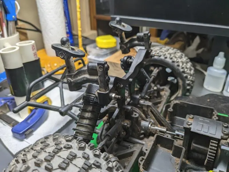

Here's a hack I did on SCT410 that may work, just flip them around?

I think I found another solution for the rear body mount. My plan is to now screw an Armma mount directly to the stock Tekno tower using the unused holes. Don't have the parts, but I've been staring at photos and positive that this will work. I also think that I will be able to use the front tower mounts as is to get the body down low.
I am currently considering the JConcepts Mugen Finnisher body.
Here is what I did on the front
MULMZ2
10
Plan on using the stock body posts for the front. If my eyeballs are correct, the stock front body posts will come through the cowl or just to the outside of it instead of behind it.
I'm sure someone has done this already. It solves the LWB body problem to some degree.

My experience for the Tekno cross arms, there light, great for racing. One wrong landing and the post are toast. Think the Armma HD post will simple make it worse. The Tekno body post had a lot of flex. Have fun experimenting.
I've read that they aren't the best. I'm not going to be doing any extreme bashing or jumping with it and I want the longer wheelbase, so I can drive it more aggressively without the possibility of a rollover. I think the rear mounts will be pretty safe (this is the only place I plan on using the Armma parts), because they will be below a wing and the front mount will more than likely be bottomed out, so that should prevent that one from breaking.
There are a lot of direct fit bodies for the standard wheelbase, it's the LWB that can be a bit of a challenge. Bodies are available on ebay and through HPI's distributor's retail site, but I personally don't want to have to rely on legacy bodies that will eventually dry up.
Does anyone know the wheelbase for the Arrma Mojave, wondering if that body will fit the LWB.
I just did the same..used unused shock holes on the Tekno mt410 towers with Arrma Mojave mounts. I'd guess others would work as well. Such as Kraton and others..
Also, with regards to bodies that fit, I used a Corally punisher body on my extended mt410. I would guess their SWB would fit the mt410. Many options out there honestly. I don't get too fancy with painting up bodies and such. Not worth the effort for me knowing in a month or so it'll be trashed.
