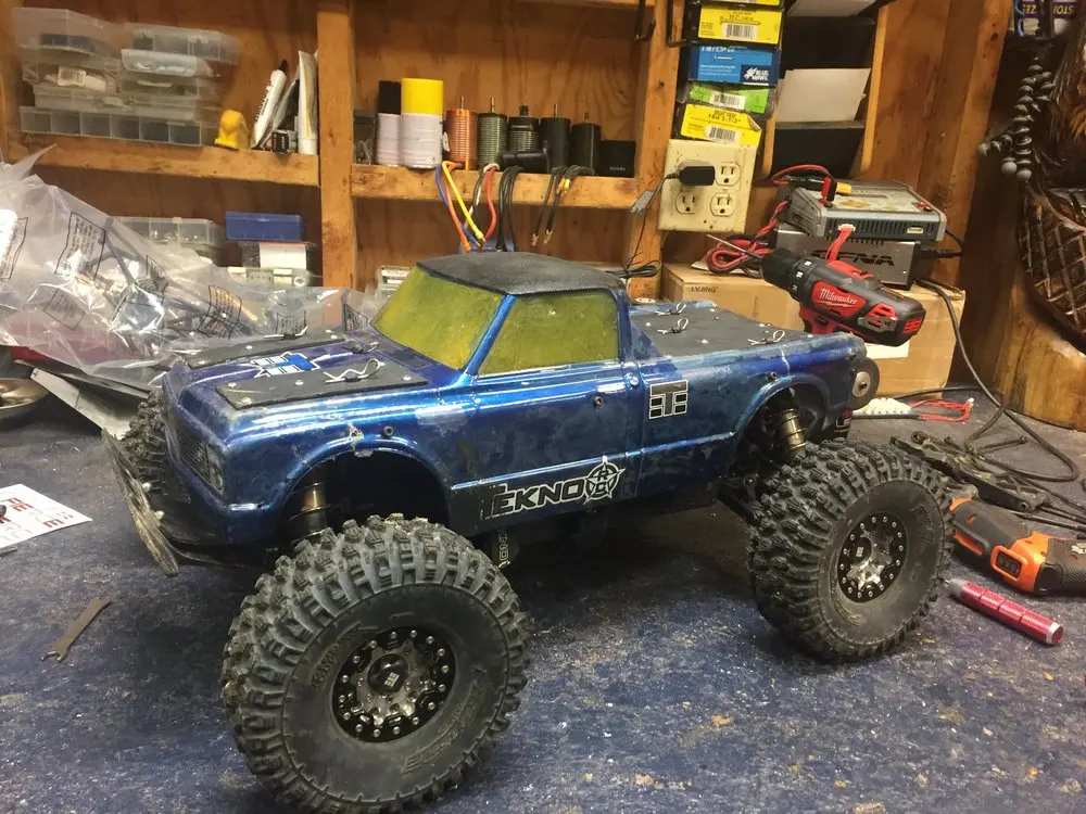

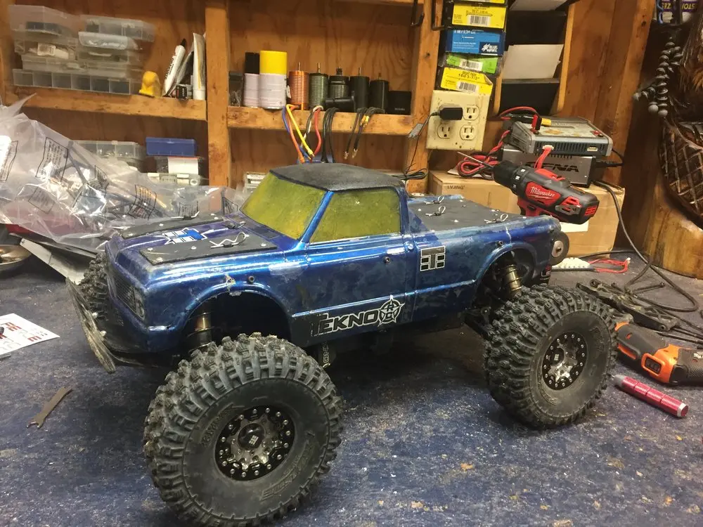

Motoworx makes 2.2 aluminum beadlocks with a 17mm hub. Very expensive though. Or you can use 17mm hub plastic short course wheels and trim the inner tire bead. Here’s my MT410...but it’s got eb48.3 arms, links, driveshafts, etc. so it’s narrowed width. 2.2 tires look weird on a full truggy width truck.

Looks awesome! Are those the hyrax tires?
