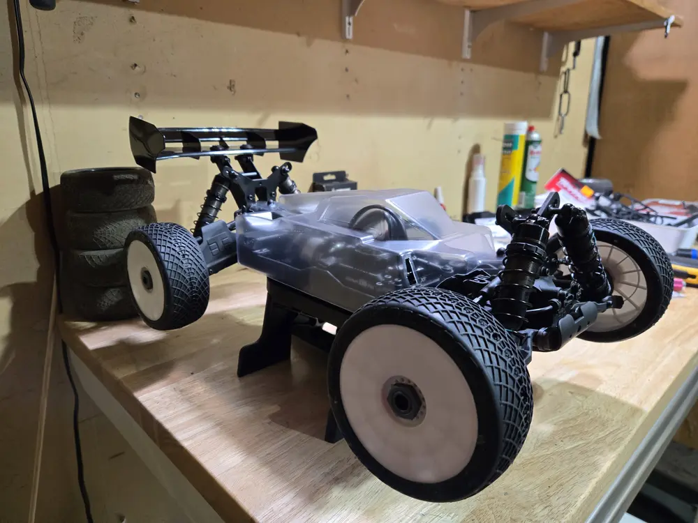

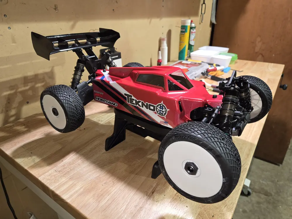

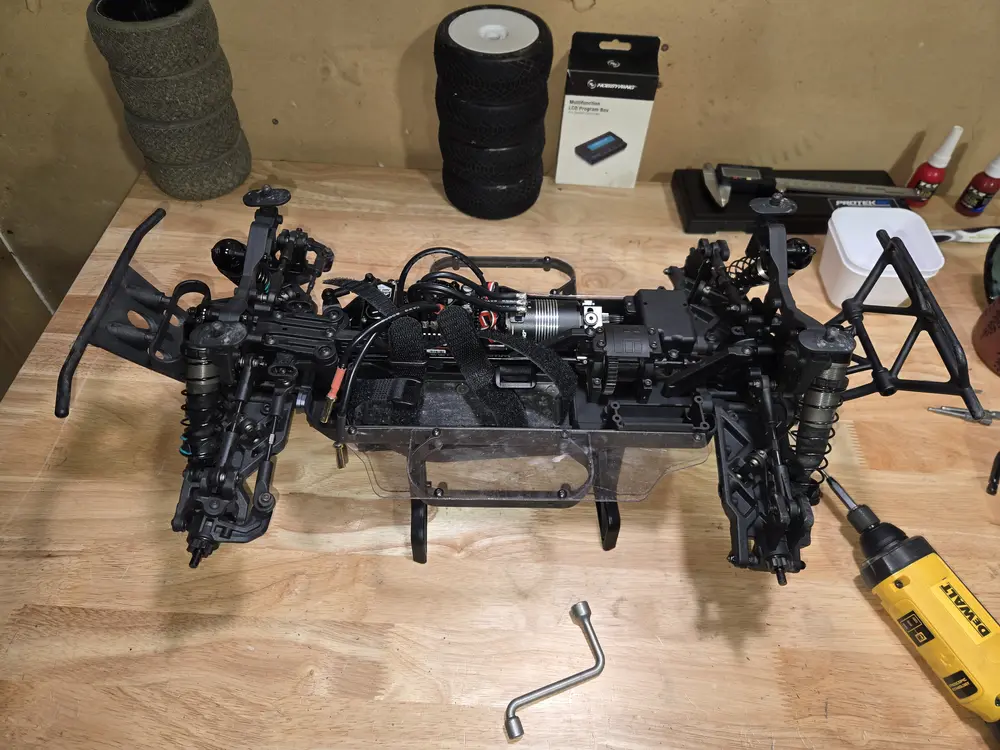

Picked up all the parts. So far I electronics and battery trays swapped out. I'll start with the front end and rebuild the shocks while I'm at it.
I am going to put green springs in the front with 35wt shock oil. For the rear I'll be using orange springs with 30wt oil.
Figured it would be a good starting point. Will be running on smaller indoor smooth clay track.
Yup... I should have ordered thevlow profile wing mount... that thing is high!
